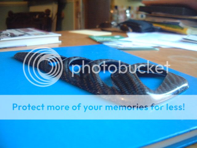

Ive made a new design that lets air out not in...........and here is my shark stylie vent......Shark being that they look like shark gills. :roll:
P.S. Just out of the mould, they still need finishing just a demo one, bit bubbley as i have not vac pump yet :( .

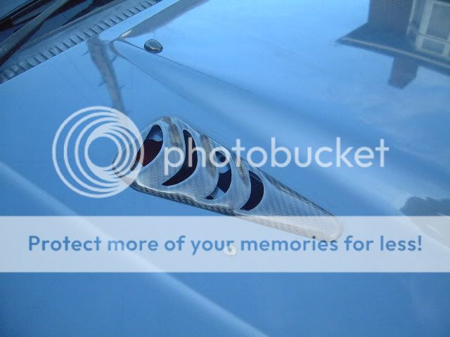

And on the car.
They will have some fine mesh behind them, should go well with my new carbon bonnet :lol:

They look good, but weird :? I wouldnt sat that they suit the R, BIT TOO CURVY...BUT IF U LIKE EM THATS ALL THAT MATTERS :D
Anonymous
i agree with ^^^^^
perhaps look better on a newer car, perhaps a saxo :wink: i jest

I Just bought some carbon and resin.
Made a mould so not sure of the price they cost :?
I thought id make something different for a change as the standard vents arnt that good.

There not on the car at the mo, as they would stick out a bit on a grey bonnet, but should blend in a bit more on my carbon one :D

I bought the carbon from ABL stevens as they had 40% off there carbon.
Too make the mould i made a plug out of plastic/P40/P38/gelcoat.
then took a mould off that.
Just need to get a good vac-pump to eliminate the small bubbles you get when hand laminating, then they will come out perfect :wink:

Looks good fella 8) Though would probably need to be a bit 'angluar' to suit the R.

i kind of like the boring old original vents :roll: reckon these would look a bit odd against the bonnet vent imo. you say you' ve got a carbon bonnet 8) they' ll look cool when matched with it.

You mix the resin and hardner together first (your then meant to degass the mixed resin under vacuum, but i have no pump yet as there not cheap :roll: .
Wet the mould out then wet out the carbon and lay it in the mould(i used two layers of carbon).
Then gently push the carbon to the shape of the mould, then bag it up and vac it down to get rid of any bubbles.
You can get away without a pump if you make fibre glass parts with a gelcoat finish as its a lot easier.
