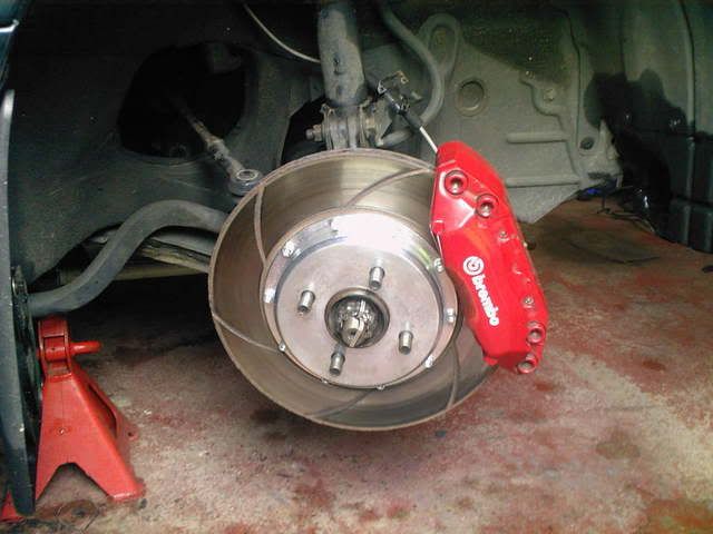

Animaldaz
Do they look like this? This is my godspeed 308mm set up. Sorry cant help you out with any measurements as my car is in storage
