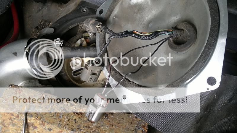

velly4
The 2 wire plug is to the pump. Black wire with the reddish/purple stripe is the active. The black with the odd grey spot is the earth.

then at the back
first i cut the std fuel pump feed (black/ red stripe)
soldier the New feed to the wire before the plug (as above)
the std feed i bent back on itself and insulated the end
then i pulled the insulation back and cut the insulation back to the ground wire of the Pump (black/ grey spot)
and placed a crimp terminal on to earth back to the body
http://sirgtir.orconhosting.net.nz/other installs/new pump feed and re-earthed.jpg
my idle voltage at the pump went from 11.6 volts to (13.6 with the std earth) to 13.9 with the New direct feed
