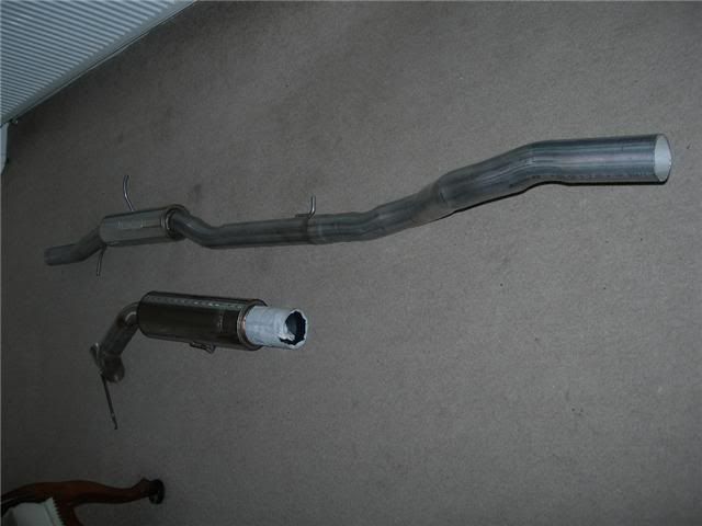

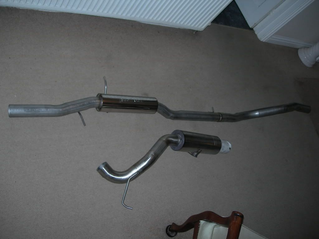

Heres a couple of pics of the custom exhaust that a few people asked for: the back box is an apexi n1 and its been made to exit the opposite side to normal.

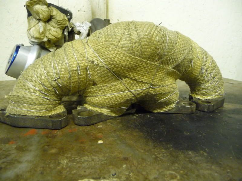

I used this stuff from rally design...
http://www.rallydesign.co.uk/product_info.php?cPath=261_262&products_id=1599
I used nearly all of it bar 5-10inchs that was left over.
I also used some of there locking wire...
http://www.rallydesign.co.uk/product_info.php?cPath=261_266&products_id=1614
When i did mine i removed all the heat shield mounting points off the manifold and also cut out the webbing between the 1/2-3/4 cylinders.
As you can see i have gone over board with the wire but i did not want it coming off as i have heared it does go hard and cracks off in the end.
