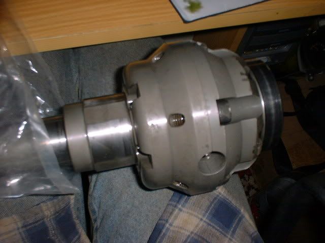

there was group buy for front diff in the oz, shalom said that if enough peep were interested the company that made them might make a few more. they were same design as torsen t2!. simon/cmng do you have any pics of the center lsd?. does it have same shape and gear configuration?

Here some pic
centre LSD.. nothing much can see since the only way to see is
look at side.. all is plate

38420-RS426 This part no. is for the center lsd..
so just put that in google and you will find a shop or two that sell it. They list it as a front but as cmng says it should deff be the center for our car. I would see if they can send pics before you buy it though.
Checkerflag also list it as front for that part no. and then they list the nismo drive shaft so i dunno?
