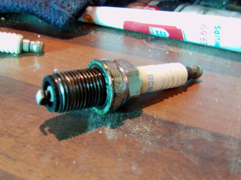

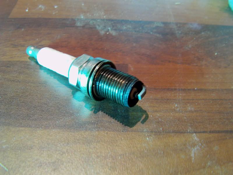

it can only either be the timing is out or possibly a defective injector/s or turbo has seized.
if youve checked all the above and all is ok then the only other solution is that you have some serious detting problem going on in which case the engine will be already boogered
what did the plugs look like when you took them out?
Plugs look fine:
Turbo still spins, listening to my injectors they are ticking away nicely.
Only thing that needs to be checked is my timing by someone with half a and right now that's not me.

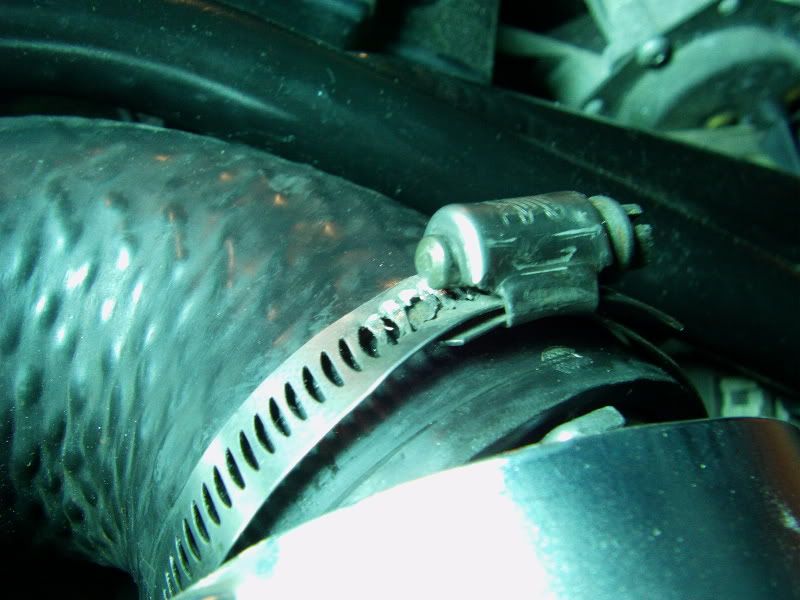

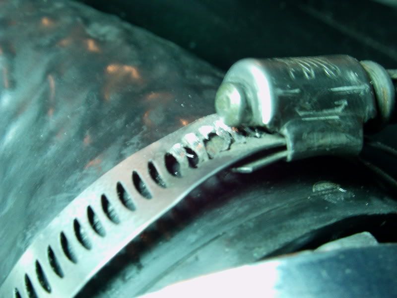

On another note, one of my clamps is not tightening fully from the intercooler to the plenum, its not slack, but not tight, would that be a contributer?
yes that could cause it as its a potential boost leak so it will mess up your fuelling as youll have irregular amounts of air entering the cylinders than is being accounted for by maf....so you could be running lean!
if that timing is out also then that will further add to the problem of det and high cylinder temps which will in turn cause high egt and glowing manifold.
you just need to keep your fingers crossed and hope that no serious damage has already been done.....ie melted piston/s on intake side
