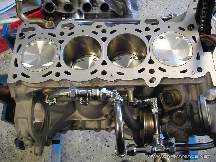

yep the stats gone and was running 20% waterwetter, never got round to ducting the rad though but temps on rad were down anyway but its the block & head that seemed to be getting too hot.
the idea of a swirlpot could be a good one though as it could be building up air with heat which will obviously cause a problem so will try that also.
would appreciate if you could take a look at a head to see what you make of it!
i know i cant ream out the internal passages but was merely thinking of opening the faces slightly where block mates to head, and as you say with the inner casting of the pump area as thats very rough cast.
danny....if i can i want to stay away from electric pump if i can possibly solve it by above ways and find the route cause of the prob.
i do however see what you mean with regard to the h/g being incorrect size for bore and the combustion chamber in head not being matched to bore which is something i will sort out when building my next lump.
as you say all those things will raise cylinder temps which is no good for a car constantly living above 5k rpm
