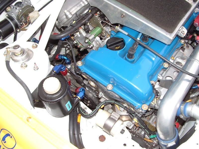

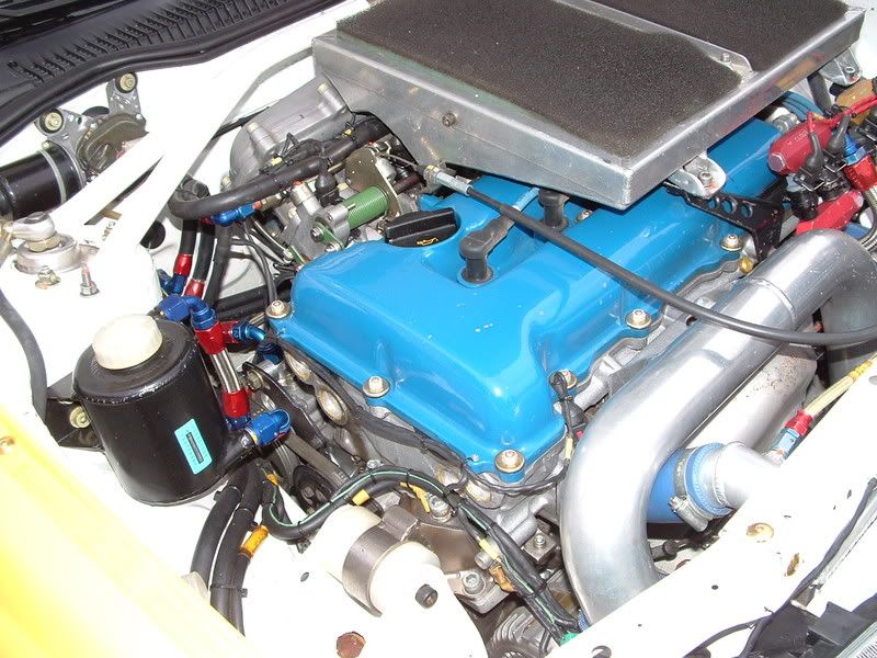

Its a rally car not a sprint car so will be subjected to longer periods of hard use, probably 15+ mins at a time! Its a group a car so not really anything special power wise (probably 330bhp tops) but by the time you take into account the amount of boost they run and the antilag i bet it generates a lot more heat than most higher power cars would on say a 20 min track session ;-)
Shots of Bardys car from Feb 2009 Blackpool Rally...
Andy, you've seen the car in the flesh? I'd bet that apart from a thicker alloy rad, no thermostat, and a decent size oil cooler there isnt a great deal of difference between that cars cooling system and any of ours!
Not massive from a visual perspective, there is an aftermarket alloy rad and custom alloy pipe runs to the engine, but that’s about it.
Even from the image he seems to run a larger water pulley, but within the engine I'm none the wiser.
When we quizzed him at the rally he was not very forthcoming...

if you look closey at bardys car.,
you'll see the coolant exit point from the head to rad is straight, not like the stupid standard elbow triangle thing!
this has to help.....
