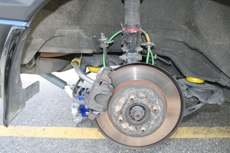

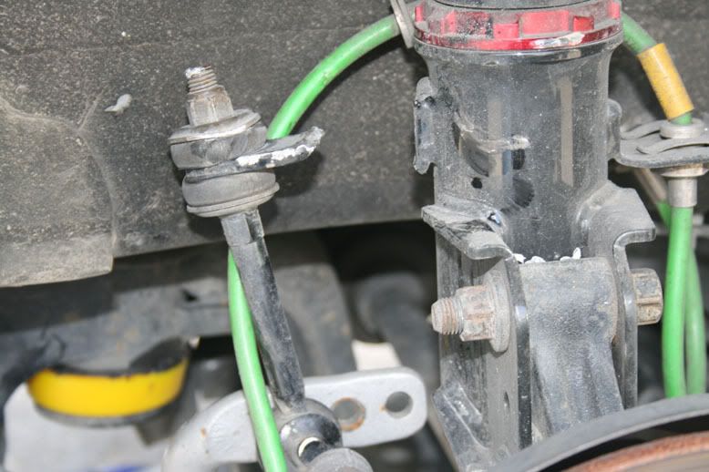

Yesterday, I broke the bracket holding the rear sway bar link..... I don't really care about the welding but the alignment and rim damage will set me back a few hundreds :(
will post pictures this week.

sad but true. The bracket wasn't the toughest one IMO.

Ive sent the pictures to the manufacturers. I expect a reply today. Ill let you know what they say. It will be sorted, thats not in question. :)

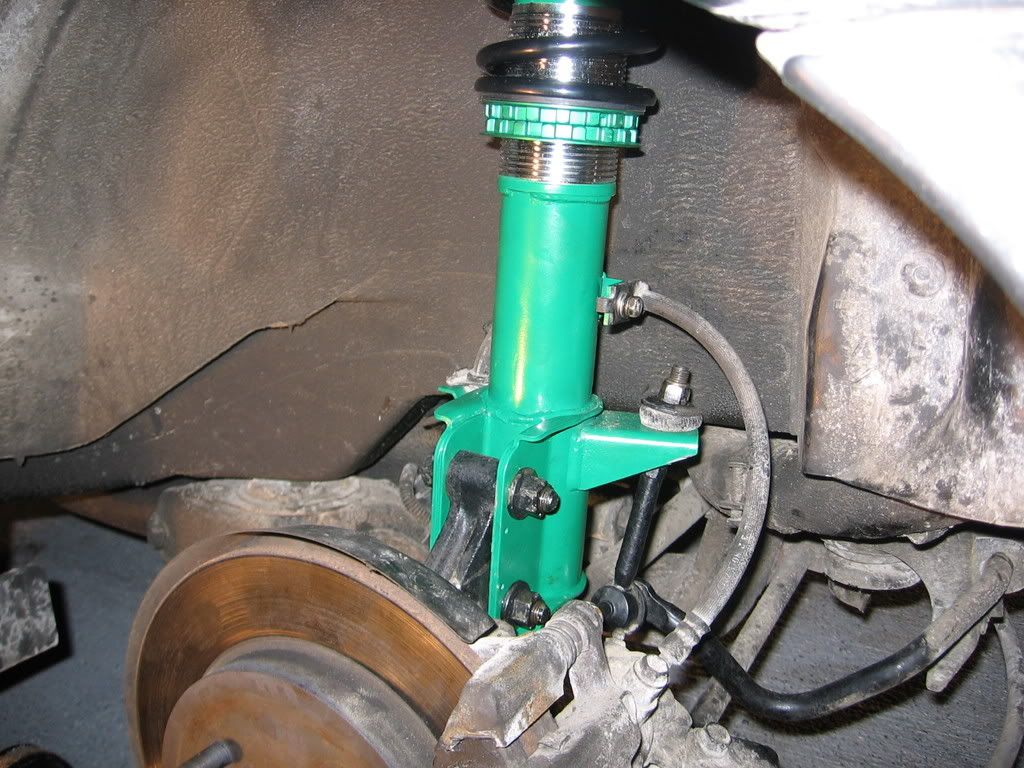

The manufacturers have confirmed that they are going to produce a batch of new rear bottom mounts with a drop link bracket similar to the design of the Tein. We will forward a pair to all customers who have purchased our GTiR coilovers to eliminate the problem :)
They say we will recieve the brackets within 10 days.

may I suggest that they increase the lenght of the bracket ?
With an uprated sway bar (like many of us here), the link is in a strong forward angle, ideally a vertical link would work best... while they are redesigning, might as well improve this too !

How are these brackets going to attatch? Are WE going to have to get them welded onto the damper? Can't say I fancy the idea of a welding torch being used on a completed damper.
McDaveMP5
FastGuy,
what APEX is proposing is a complete replacement of the bottom part of the strut. You will then have a factory look, no welding marks, no nothing. Just need to re-align the rear and your good to go. Cheers,
