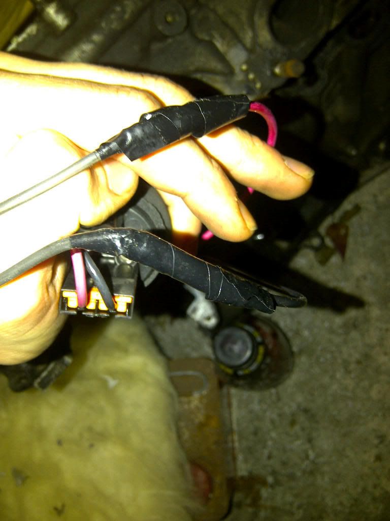

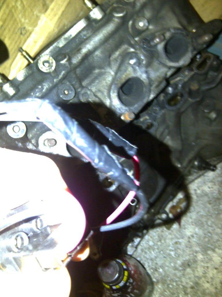

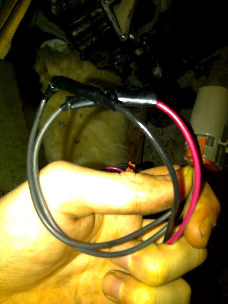

chrisyleigh
I dont know if im running lean or not just wanted to see if tape* is good enought i was worried about it being near fuel as i thought it might corrode the tape cheers chris
I would have soldered them simply because it's a pain to have to pull the pump back out to fix a wiring fault.
Those are outside the tank aren't they? Heat shrink is always better than PVC tape but it will be fine. Just stick some more PVC tape on if you're worried :)
chrisyleigh
Oryt cheers mate and i dont now i was planning on hopefull just useing the how to guide haha so should be fine spending alot of time on her this weekend
I just re-read George's post and agree you should check if they've been soldered and not just twisted together with a bit of PVC tape.
