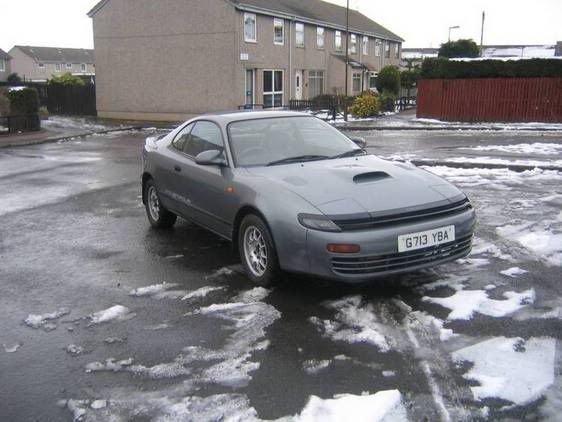

celicaGT4st205 said:
There is also a special lightweight ST185 with a different gearbox to the others.
thats the one i used to have 8) very early JDM, ultra rare too :wink:
Yeah, I only know of 2 or 3 in the GT4OC. Closer ratio also
yeah, proper group N box, the interior was p!sh but in theory it was meant to be binned. wind up windows and no AC etc.
celicaGT4st205
Thats the badger. Its a GT4A I believe. No electrics or anything. Also has short shift and like I say, close ratio box.
Still, like all ST185's, embarrassingly slow compared to the ST205. lol
Fire & skill
Vintage member
E152F boxquite torqy though :lol: but yes - no match for an R either, but same engine as the MR2 tubby, quite a bit involved to get more power out of them with the 'fuel cut defender' :lol:
