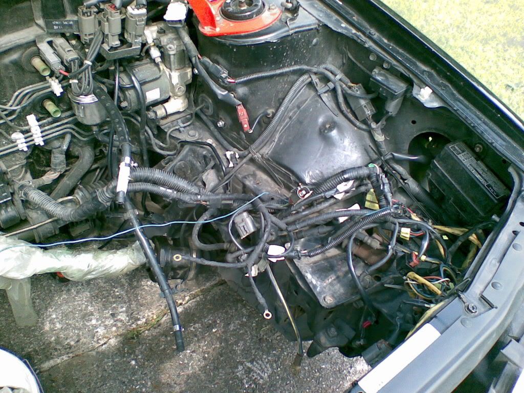

nice one, ill check it out tonight and tidy it all up
the amount of unnecessary stuff on these engines
want my engine bay like that guys RS2000, !! (in my dreams)

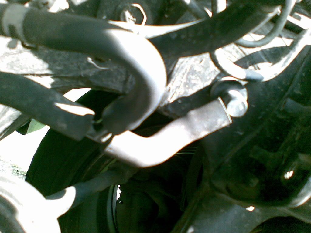

Here is what i did with the 2 pipes, think this will be ok
one connects to the T on the other which goes into the chassis rail
youngsyp
It will be ok, as long as that is a 1 way valve it connects to.
Why not just bin the surplus pipes ? You don't need then and it will mean a more tidy engine bay !
The only ones you will retain (unless you can get to behind the plenum and remove them altogether ?!)are a 1 large and 1 small vac pipe that come from the plenum area. You can either connect these together or, better still, block them both off !
