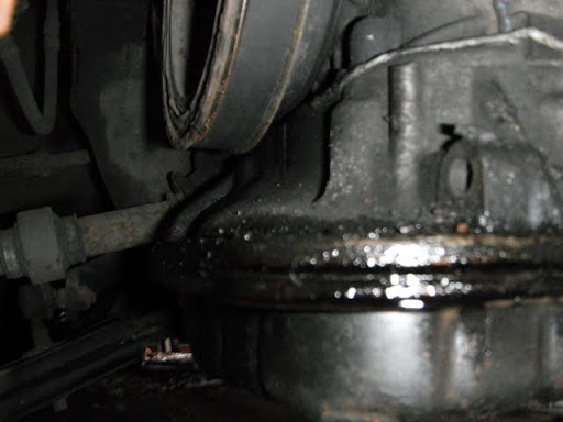

Whilst it's on stands, does this look like a leaking sump gasket:
All the oily crap seems to be around the join rather than pissing out of any of the seals above it.
How easy it that to change with the engine in? Is it an MOT fail, because I should probably sort it out now if it is (plus I haven't done my fluids change yet and I don't want to have to drop all that synthetic oil to change the sump gasket).

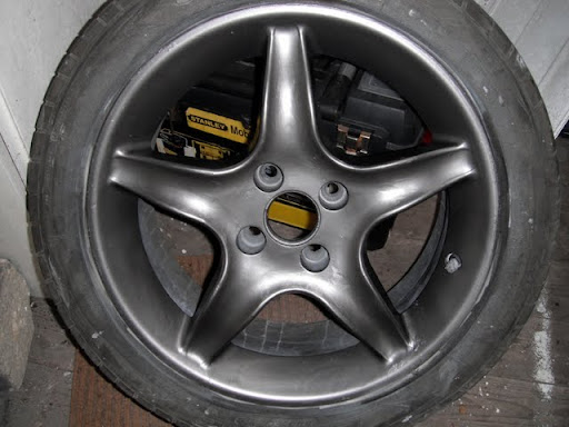

It hasn't all been sitting on my arse... I did have a go a refurbishing my wheels too seeing as they are off:

Sump is not bad to sort it is not a gasket it is sealent just make sure you clean it proerly once you get it off before resealing
So I'm OK to just take the small sump off and put some new sealant on it? The baffle plate etc will all stay where they are and not need to be touched; I remember a that there's a second set of bolts to get them out, so I was hoping it was just a matter of draining the oil and then resealing it.
This is definitely a job I can do myself... any recommendations for the sealant; Halfraud's finest?
It looks like someone used orange sealant last time; is that the "high temperature copper" stuff?
johnsy
easy job!
let the gasket harden before you offer it up and tigten ,or all the paste will just squeeze out.
johnny gtir
Yes undo oil drain plug.undo all the 10mm bolts prize off the sump pan get a stanley blade or similar clean off all the old sealer from the bottom of engine and the sump pan get a cloth with some solvent on ie petrol wipe it all clean check the sump pan is in good condition not weaping due to corrosion. run a nice bead of sealant (instant gasket) round edges of sump pan enough to get a good seal but not to much it squirts all over. i personally would offer it back up while sealer is still wet to get a good seal refit all bolts leave to dry for as long as possible at least a couple of hours refill with oil job done. The orange sealant you mention is just instant gasket i have a small tube from nissan it is orange but i also have a larger tube that fits in a silicone gun which is black all instant gasket will be high temp i would say

Screw waiting for the MOT. - The sump is off and I've given it a bit of a bashing. It wasn't particularly dented, but when I put a spirit level across it I could see it was lower in the middle and I figure it can't hurt.
The front edge is definitely showing some signs of battle scars, but other than that it seems pretty good, and I don't think there have been any issues with the pick-up.
Is the best thing to go around the bolt holes with the sealant, let it start to harden, loosely assemble... wait for half an hour or so, then nip it up?
I figure I want a continuous bead all the way around, and I don't want to squish it too early to avoid squeezing it into the sump or making it too thin to be an effective seal. - Nissan says to fill the grooves and only go inside the holes (not around them); does it matter if I don't put the bolts back in following their sequence as long as I do it in a diagonal fashion (to prevent it distorting)?

Anyway... the sump is back on; I just did the bolts up finger tight and left it for 24 hours. Is there any particular torque to finish with, or just a bit tighter than they are?
Can I do the rocker cover the same way, or is that a stupid idea? It weeps just a touch near where the breather is, but I can't bring myself to buy all the gaskets just to sort that out.
Thanks for that; I always spend ages trying to find the right pages!
I don't think my torque wrench goes as low as 7.5Nm. Tighter than hand, but not much tighter than that it is then!
