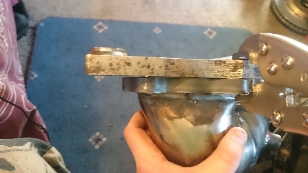

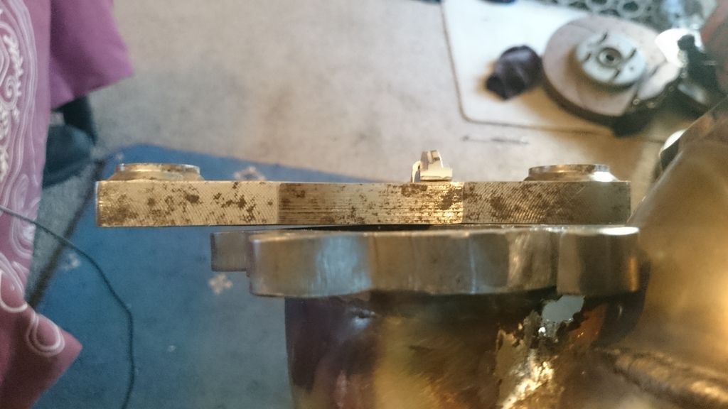

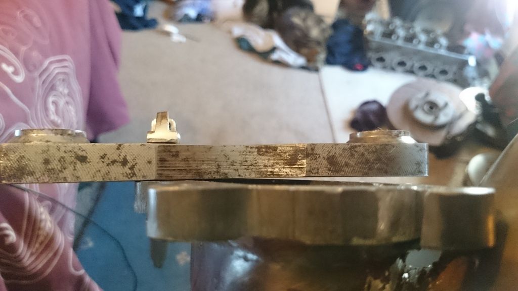

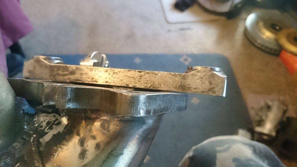

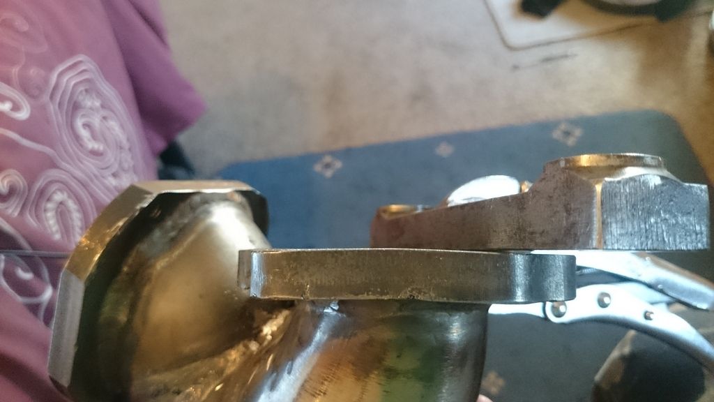

The flanges were machined flat and during welding bolted high tensile bolts so that they move.
I believe that the warping is minimal.....as I have checked each and every one of the elbows.
Sorry....
I bought a new downpipe from somewhere else (IE not one of Bogdans) and the flange was warped by 0.8mm. Bolting it on the turbo to the point of shearing the bolts wouldn't close the gap, so they need to be machined flat after welding.
johnny gtir
Depends on material etc if I had bought that downpipe I would of took it back. I seen where you tig one side only ie front or rear or oppersits and not all the way round which pulls it straight even on thin flanges. That was stu AAS who done that and is well known from standard to kit cars to high end American cars. Welds for race teams etc
KieranEG6
I don't know what you would call minimal or what you checked them with.
Straightest thing I have to hand at the moment is a steel brembo caliper adapter bracket.
I'll have to check mine now; there's still time to machine it because I haven't bought gaskets yet.
keensie
I didn't see a problem with mine i checked it on the turbo without gasket, i've used the thicker gasket all seems ok maybe i was just lucky.
keastygtir
I am a bit surprised that they are warped like that. I haven't checked mine yet but best drop it off to the machinist. More expense!

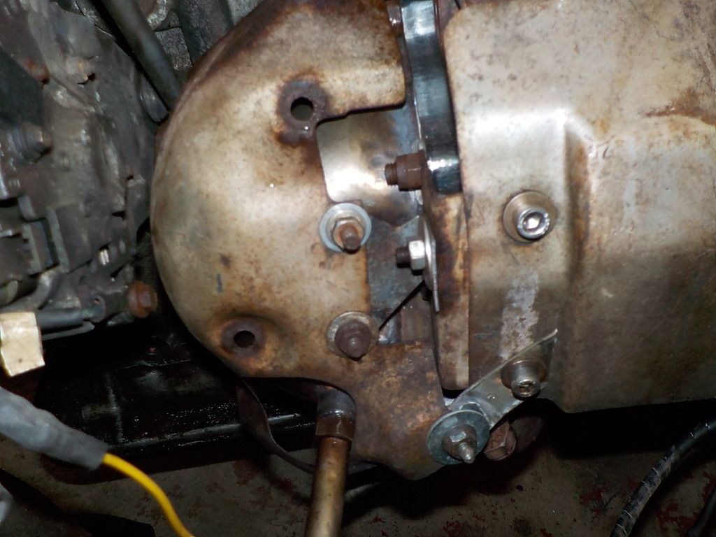

BTW is your engine mount rubber split or is it just the picture?
^ Split, it's on the list for replacement, good spotting though!! Same as the front stabiliser mount, that's shot..
