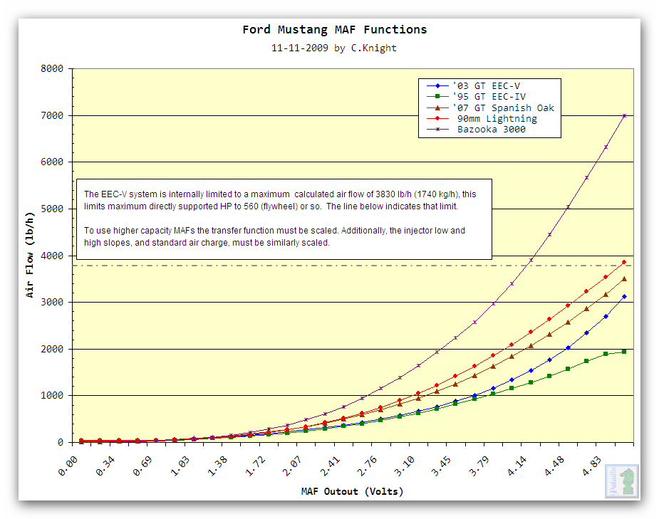

That is not correct! With the 3L3A-12B579-BA a friend of me has 475 PS @ 3.8V. So i think there is much more possible or what you think ;-)
Ok, well that's good :_) So you're saying in a 4" pipe it will go more than 400bhp? I know if you increase pipe size, it will flow more air and thus more bhp.
Asking on eectuning in US, and table conversion works out to be ~400.. Will have to find table and upload it here.. I may have been calculating 3.5" ..
this'll do for now..
