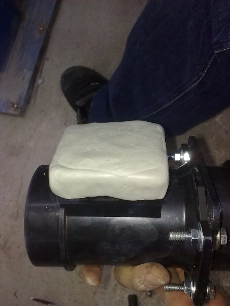

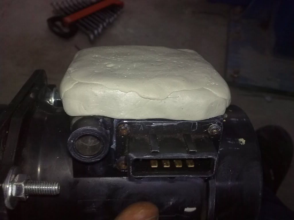

That's what I already said (well sort of LOL) I just forgot about the O ring..........Not sure yet....but probably just supply
The ageing OEM Z32MAF as a unit seems to rely on the internal mastic type seals surrounding the sensor, plug and lid and even when new have been shown to leak, especially when being used under boost pressures it wasn't designed to withstand.
On these units the sensor would be sealed into position this will seal the MAF unit completely, the lid as on the OEM MAF would then held in place by the sealant filling the box. The OEM lid could be re-used or if your concerned about the look an alloy lid could be fabbed up and again sealed into position.
