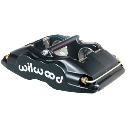

well they are wilwoods so have 4 bleed nipples and i guess it does not matter which way round the calipers go as there is no markings to which way round they go i have bled and bled these brakes i did think it wasnt the cylinder as on a staright they are fine just round a chicane the first press drops to the floor i dont think its pads binding as i have just changed them and lubricated the pistons and none seem stuck it could be air in the pistons still i guess but i cant think of how to bleed them better and when they work they work very well

4? All the calipers I've seen normally have 2 nipples at the top and a pipe connecting the 2 nipple holes at the other end. Like this.
Although I guess as long as you bleed from the top nipple it shouldn't make a difference.
