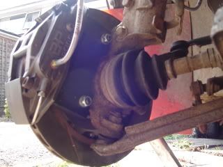

check at full lock as well as my hispecs rubbed when turning on ball joint
yep i checked it on full lock and with wheel straight, also with suspension loaded and unloaded! 5mm is the max you can really go and thats cutting it a bit fine to say the least
trouble is mark, thats ok when disc is new, and car is mainly used on road! but if cars primarily on track and your hard on the brakes all the time then you only have just under 2mm clearance to allow for heat expansion and any disc runout which may occur!so not much leeway really.
Kev@Apex
So we can move it all in 5mm?
And will 5mm still give lock-to-lock clearance ?
2mm runout!! What sort of crap do you think I'm selling. Our runout is typically 0.01mm with a max of 0.02mm
yes sorry my mistake:oops: thats what i meant to say but typed it wrongly!
yes they can be bought in 5mm to still give a 2mm clearance all round from balljoint.
is that ok or do you want any other measurements

So whats the story then, is it gonna be a 10mm spacer (for 37 offset) were going to have to use to get the brakes to fit or are we going to be able to get rid of spacer completely, just would like to know as Ive been speaking a to a few people about using spacers and no one has a good word to say about them.

im running a 35 offset at the minute and at times ive had scrubbing so realy i cant run any more spacers etc on the front to clear brakes

thats the prob i got at the mo with these fitted!
if spacers are fitted then there is contact with arch lip, hoping the extra 5mm will solve this otherwise im gonna have to roll the arches to try and gain more clearance.
will be trying a different set of wheels this week to see if i can reduce the spacer width
ashills
could it be the pulsar setup with respect to ball joint position wont allow such a big caliper as the k sport or is it similar size to others ?
the caliper is a big old lump, but then again it is an 8 pot!
its also the disc width combined with caliper that i thinks causing the problem here.
they are excellent quality parts and im sure they will perform very well, only kev can explain more though what his thoughts are to try and cutdown this spacer width.
these other wheels im trying have previously been shipped in from the states and cost around £1200, and im preying that the clearances are better on them, but i wont know untill i remove them from the car there fitted too.
i feel the angle grinder maybe coming out soon and flared arches may be fitted if they dont fit over brakes:shock:
