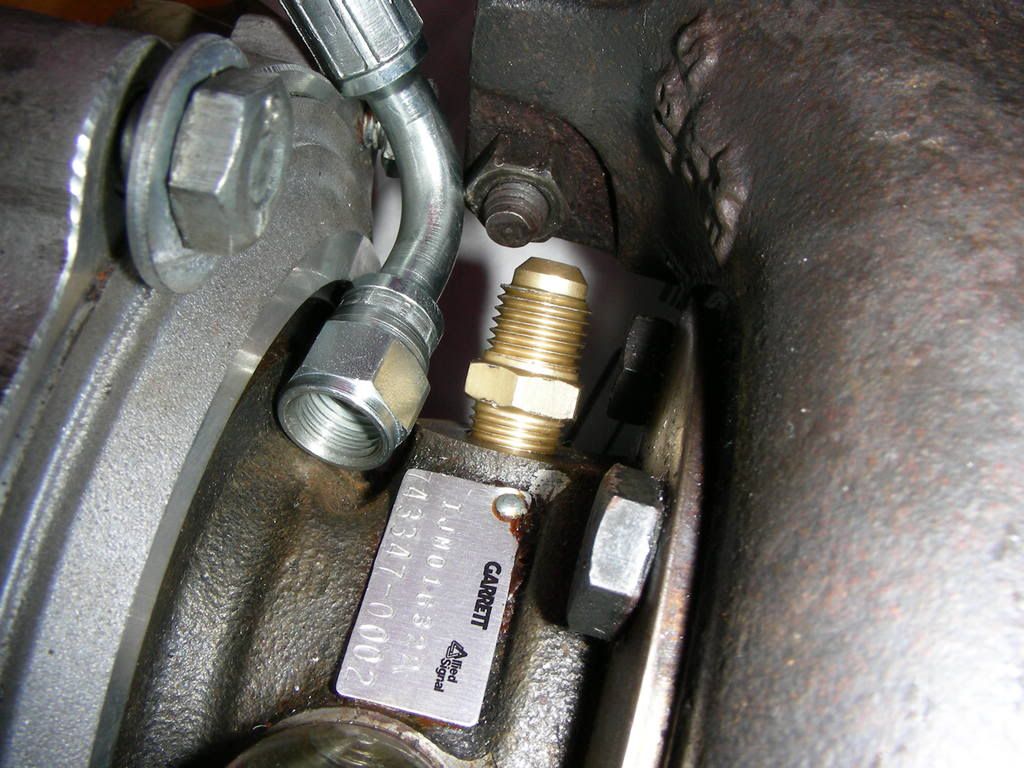

I think I'm just going to go with the hoses from Ben.... I have fitted them to the turbo and it's all ready, manifold in place, ready to bolt on to head and plumb in.

Bought an oil inlet restrictor and a different oil feed pipe to fit my gt2871r but it's no good.
There's not enough room to attach oil feed pipe... :doh:
I'll need to try to source a restricted banjo bolt and revert back to the other hose solution oil feed pipe.

Those steel pipes are easily modified, , if your quick with a hot torch you can do it without heating the rubber pipe,
Other than that wouldn't a brake pipe nipple fit with some copper pipe to rubber pipe and a jubilee clip??
I know there's many different thread sizes of the nipples there must be one that fits and you can choose the type of face you want, any local garage can help i'm sure?
