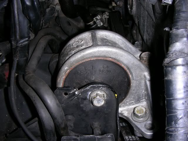

That mount is easily removed. Just slacken the nut on the centre bolt, take the weight off the mount by supporting the engine/gearbox enough that the center bolt through the rubber damper becomes loose... free to turn. You can then pull the bolt out and undo the three fixing bolts.saddler said:Can this rubber bush be removed and replaced ??![]()
Thanks in advance
Excellent, i'll have a bash tomorrow or next weekend 8)Braveheart said:That mount is easily removed. Just slacken the nut on the centre bolt, take the weight off the mount by supporting the engine/gearbox enough that the center bolt through the rubber damper becomes loose... free to turn. You can then pull the bolt out and undo the three fixing bolts.
