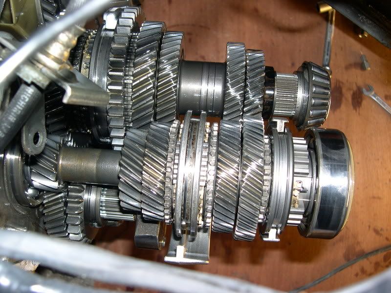

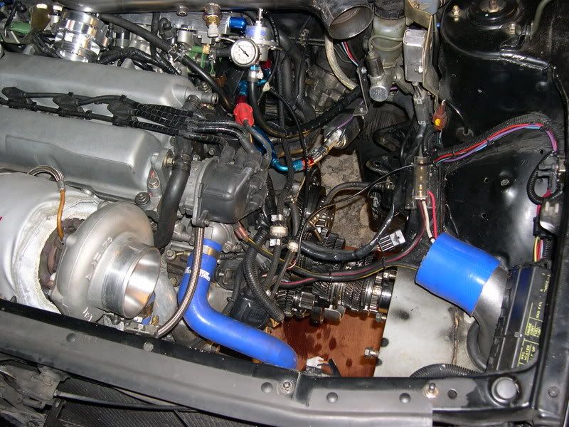

Time for a new gearbox!
My standard gearbox has finally given up..

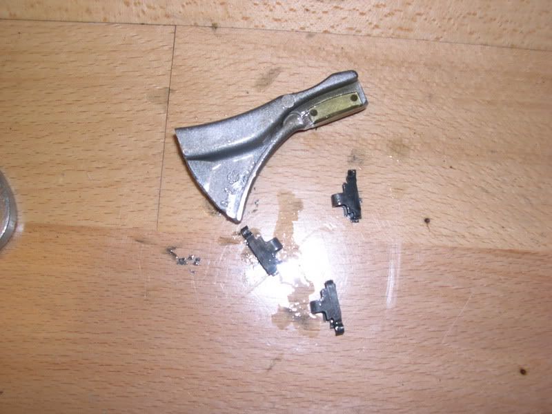

It got stuck in 4th. So I pulled the end casing to have a look. As expected it was the 3/4 selctor fork that was broken.
After 3 years of hard abuse. I was beginning to doubt if it was a standard gearset in there...
Im making around 500hp and has done many low 11's with that gearbox.
And when it finally gave up it was the 3/4 selector fork that broke..
The gearset still looks fine. Im actually considering changing the selector fork and driving on with this box..
It the first time I look inside a GTIR gearbox. Can anybody confirm that this is a standard gearset?
Can anybody tell me whats the 3 little things next to the broken fork on the last picture?

yep the three little bits are 3rd / 4th gear syncro hud clip springs , they help to hold it in gear. but they look like there are fooked in the picture.

yes its deffinatley the standard box, and dont be supprised as these can hold alot of power, its usually bad shifting that kills the gear teeth i myself have put just over 500hp through a standard box and it was and still is fine, just replace hub syncro springs as si pointed out and get yourself a billet 3/4 selector fork from ppg.

I have a low mileage spare box lying in my garage. Just pulled the end housing to have a look inside it. Everything looks nice. Will probably put the spare box on instead.
But anyway - is it possible to change the selector fork in situ? with just the end casing of..

yes it is possible, u need to remove both gear clusters and selctor rods all as one, hope this helps.
