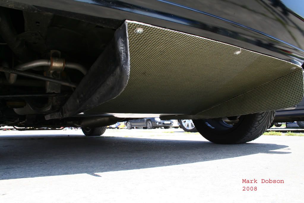

As for the rear defuser I have made a quick kevlar/carbon one up to see if it works, will take a mould of it when completed. Although will only remake it in G/F as I had the kevlar left over, its to expensive to buy these days.

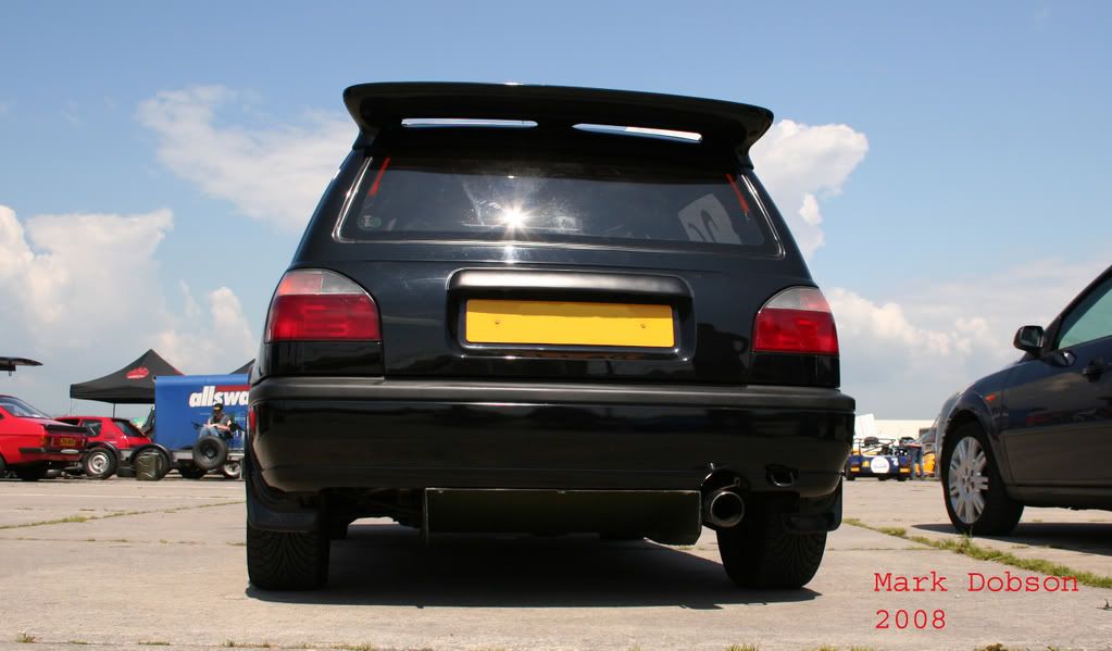

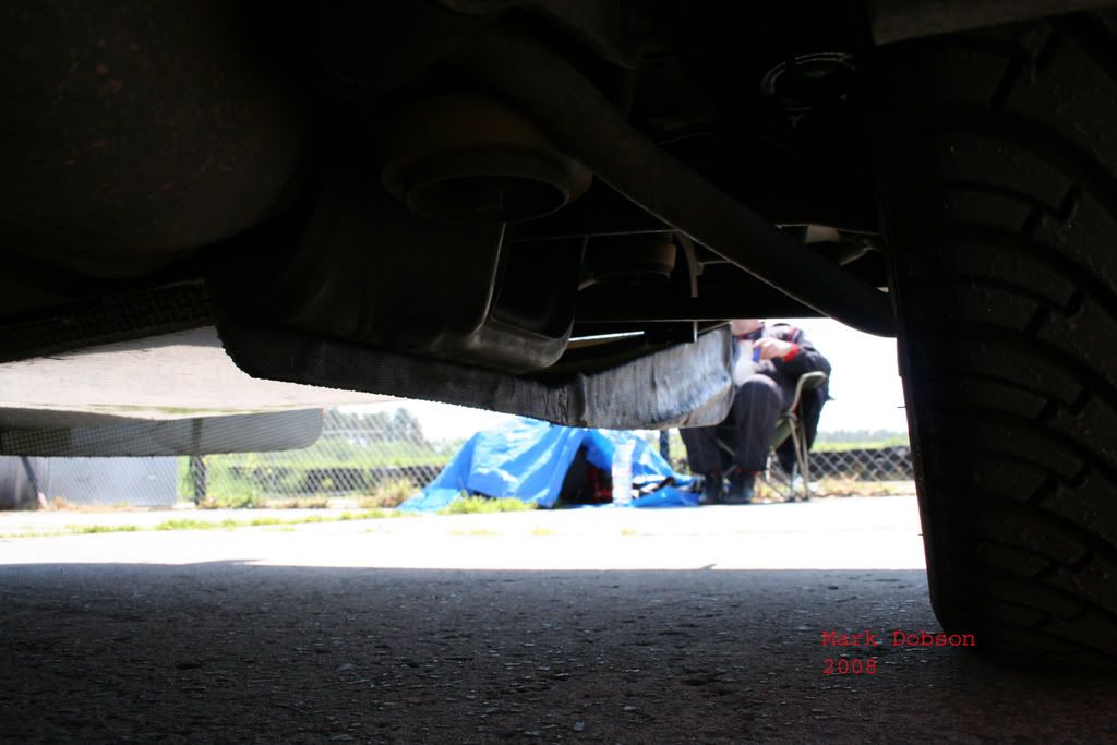

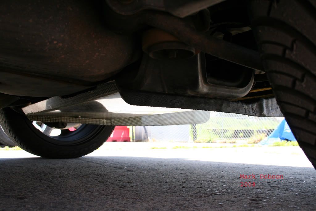

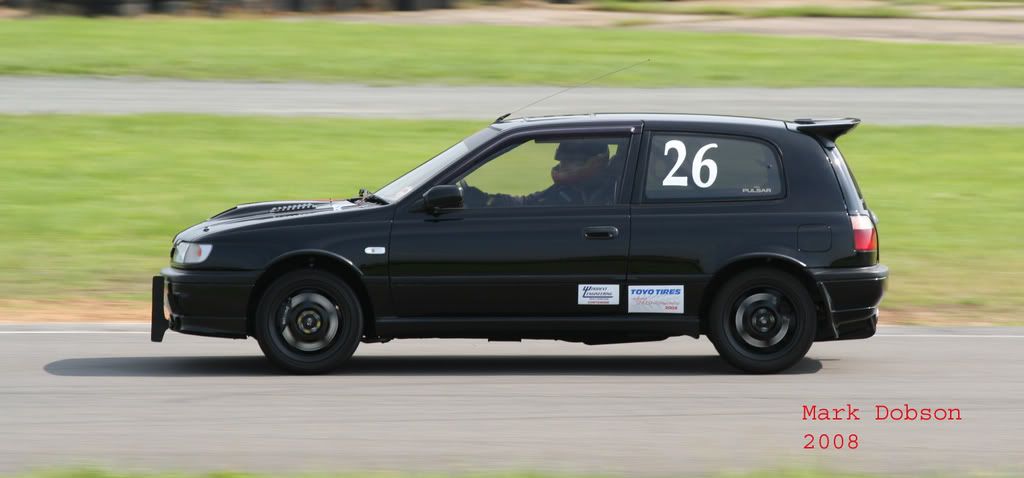

Ok I went down to Pembrey to watch the sprint. I spoke to Phil and the deffuser looks amazing. I deffinitely want one of these even if its for looks alone. I did take some photos of it so here they are.
http://i8.photobucket.com/albums/a12/dobby84/PHILGTIR1.jpg
http://i8.photobucket.com/albums/a12/dobby84/PHILGTIR2.jpg
http://i8.photobucket.com/albums/a12/dobby84/PHILGTIR3.jpg
http://i8.photobucket.com/albums/a12/dobby84/PHILGTIR.jpg

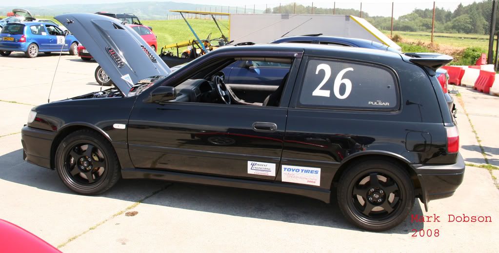

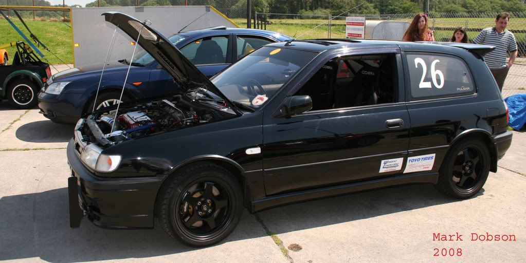

Also here are some photos of Phils car. You would never guess he had grp panels on the car.
http://i8.photobucket.com/albums/a12/dobby84/PHILGTIR4.jpg
http://i8.photobucket.com/albums/a12/dobby84/PHILGTIR5.jpg

Thanks for the pics well done specially the ones under the car ...
Yes the bloody intercooler pipe came of not only on the first timed run but also the second as well, after tighting with a socket set, never done it before...think a small amount of oil contaminated it, got it fixed on Sat night with a longer piece of hose and 3 clips...did not move today.
Car does not seem any quicker than last year and I had brainfade on the last run and **** up the gears...( was 3rd) not sure were to go from here now will have a think over the next few days before making any rash decisions.
Thanks again for the pics will be modifying the defusser a bit more before making a mould, will keep you informed.
