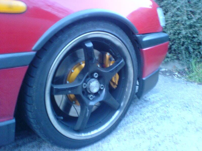

stevepudney said:
Well done mate but............
you got the discs on the wrongs sides :doh:
iv seen many cars with the grooves facing like mines so just put them like that, i dont suppose there is really anything that can go wrong if they are put on any direction??

Thats what hi spec tell you, the same way they tell you that their delivery times are only a week :lol: I didnt think the hi specs had directional vanes anyway :? The grooves on my AP's run the other way and i think i'd rather believe AP over hi spec any day of the week ;-)

thats kind of the point, the grooves are there to clean the pads not as many people think to throw cr@p away from the surface of the disc, the leading edges also provide more bite when it cuts into the pad
bob, think about the application, brembo and ap are both better known for racing applications where pad wear isn't an issue...hispec are better known for big brakes for road cars where pad wear is an issue..
makes sense why opinions differ ?
Yes I was told if I wanted them to work better face the dics grroves forward but it would shorten the pads life span, And the other way if I wanted a longer pad life but less performance.

Just incase anyone didnt see it in the thread a while back heres the AP diagram which shows which way the discs are fitted. Unlike the wilwoods/hi specs the AP discs have curved vanes for cooling so they have to be fitted the right way round to work properly and you can see from the diagram that on AP discs the grooves are machined so they point forwards.
