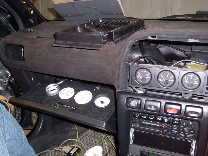

As i have not decided on where my guage is going can people throw pics and best "Tidy" area to install guage up so I can decide Thanks

jpward said:
@ Club
My guages are loacted in my glovebox:
Look in my thread in memebers cars for how it was done, see page 25
jpward
Mr GTiR said:
I told them to send it as a gift and they did as they we're told :thumbsup:
Had a look on my feedback but it was purchased too long ago. I also suspect the $ was a lot weaker than what it is now as that makes a bit of difference. Mine is located in the 3" elbow. I had a bung put in for the AEM when the elbow was made ;-) As JP has already stated the decat is too far down the exhaust IMO.
:shock:
Andy what have you done to that dash!!!
The word "Tidy" I did mention it ahum :lol:
Mr GTiR
Cheeky feeker, that's a picture of it when it was being worked on. Everything is now tidy and stealth 8)
Here i would hardly call having the glove box open in order to view my guages "Stealth" :lol:
But each to their own :p
