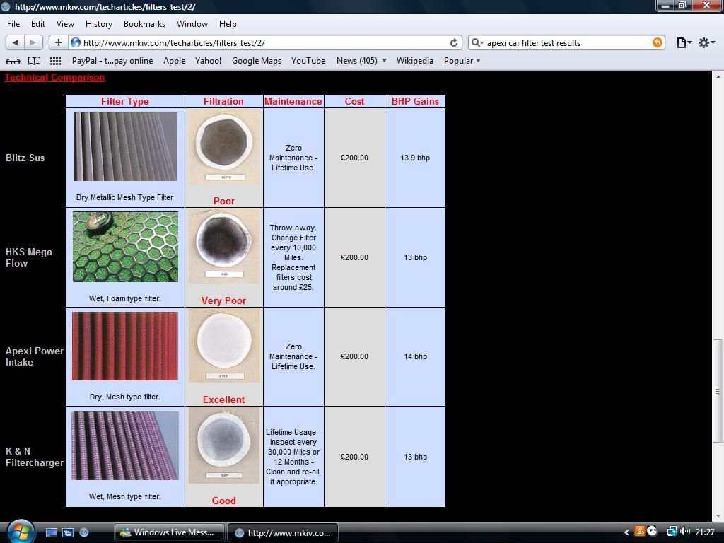

Fair enough. So were talking ca 300hp then, as Im presuming theyre not tuned or it probably would´ve stated that fact. So, these filters are probably okay for most gtirs with a standard turbo.
My claim is that the apexi specifically will hamper flow on a gt3071@ca 2bar.
