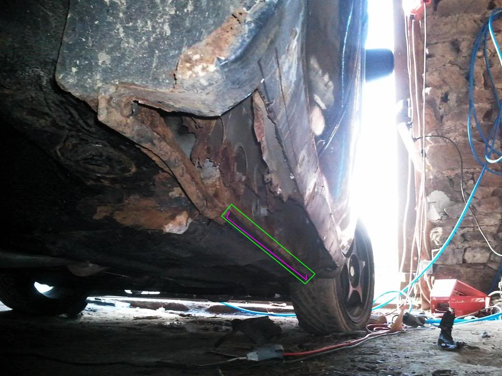

welding sills and making new rear jack points ??
Hi All i Have just finished 1 sill and undersealed the whole back of car (taken all old stuff of and sanding then new stuff on) will get some photos up as soon as i can. However the car was in a very bad way (taking alot longer than it should ). :( but its gettin there and as to sellin it it will never get sold as being a uk one maybe not the best uk one im sure but im keeping it. As for photos i will get some up very soon

Maybe not as good as other peoples work but im happy with it just need to find some 1 who can make the same paint up in a spray can once i have done the other side :)

Looks good to me and no reason why that won't last if you cover the insides with cavity wax.
Were they 5 door sills? Pattern parts I assume, how was the fit of them?
Hi
Yes they are 5 door sills quite easy to fit just need to cut 2 bits out really and away u go un less the inside wall is rotten like mine was that needs replacing but if thats the case most proberly better to reshell like alot of people have said on here i only did the work due to the fact that it is a uk gtir not an import
