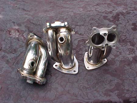

This should give them some ideas
these are for the S14 but should give them a good idea of what we want 8)
I think the one Kev has got is designed to still work with the aircon :?: so takes a tighter route off the turbo than it would have to with the aircon pump removed so we should be able to take advantage off the extra space available without the aircon pump and have pretty smooth pipe run off the turbo and down to the catI'm thinking of having it made with seperate wastegate pipe simular to the item Kev R recently purchased.
I don't think you'll be able to have a true 3" dump pipe with a twin pipe setup as the outlet on the turbo is only 2.5" IIRC :?: so it would have to be a 2.5" going up to 3" like the ones in the pics above though the extra capacity of the wastegate pipe would help alot also theres this option to which would be a true 3" pipe off the turbo, though the twin pipe setup is supposed to be a better design.What i hope to get is a new downpipe with a TRUE 3" dump pipe so it will be a turbo back 3" system
