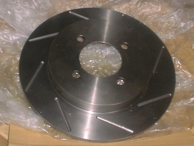

I have 304mm AP's fitted on the front with pagid grooved discs and pads on the rear which I find to be a very good set up for both road ans track day use.
I haven't managed to get them to fad yet 8) :D
rob
As you can see the pagid disc's don't come cheap, But are very good indeed, I have the 16 groove by the way just in case you where going to ask :wink: .

Can you still get the Grooved rear discs for £140???
If so what make are they???
Need some new rear discs for my GTIR :wink:
GTiR_Mic
Im sure 3G Brakes do rear groved discs for the R. They are also made from the brembo molds and they don't come wuth the same price tag :wink:
Michael
paulrandy said:
I can do you a pair of these for £140 delivered.
Thats a lot of money for two rear disc's :shock: , Who make's them?.
My pagid one where £140 a pair and look a lot better made than them :? .
rob
