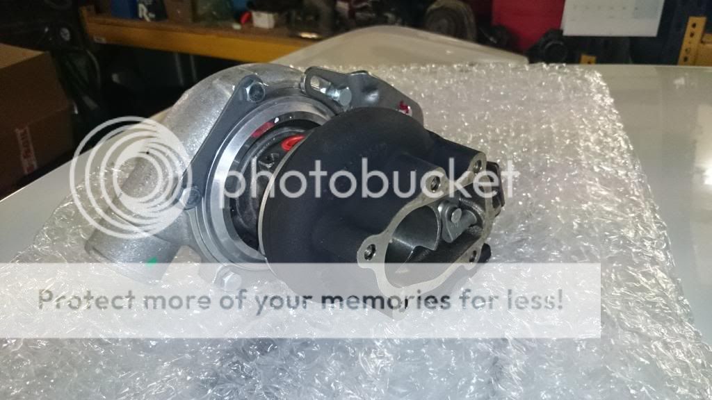

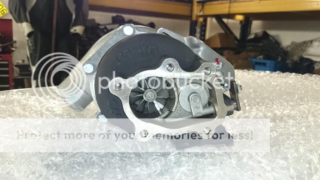

£1760 with the ceramic coating and stainless steel heat shield and bronze bearing cages.
Yeah I figured something around there. I'm not jealous- much. If money was not an obstacle and I managed to be sensible I'd get the same.
