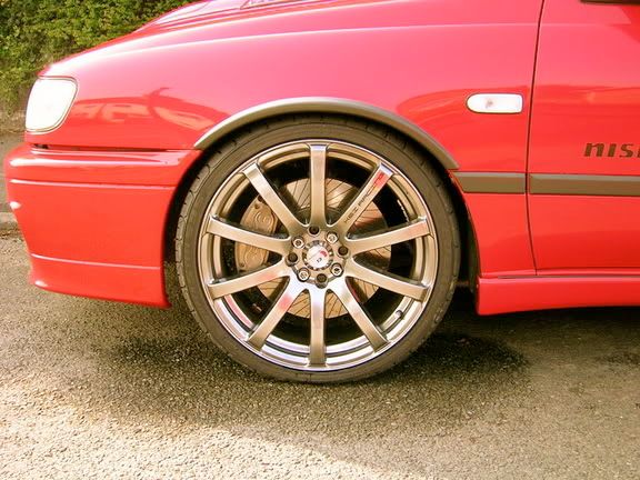

Stoned
I got mine for £425 2nd hand off this forum. Work much better than standards!
Just keep an eye out. A bargain will come up sooner or later.
