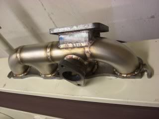

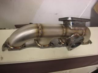

I have one of these with a 3076 and it could be why I cant make any more power than 440bhp as I have a restriction. If you are looking for more than that I would not go down this route.
I got mine for cheap so I didnt mind so much.
Smo
As dobby has said it doesn't look to me like it flows the exhaust gas terribly well - looks like the cylinders are fighting against each other rather than being channeled towards to turbo.

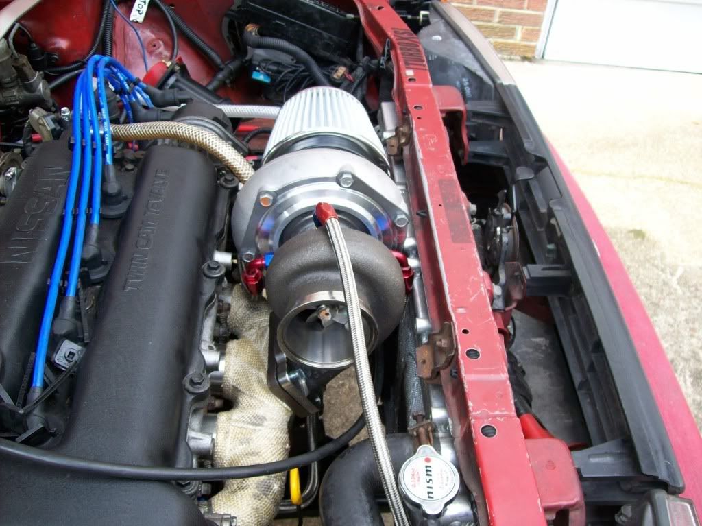

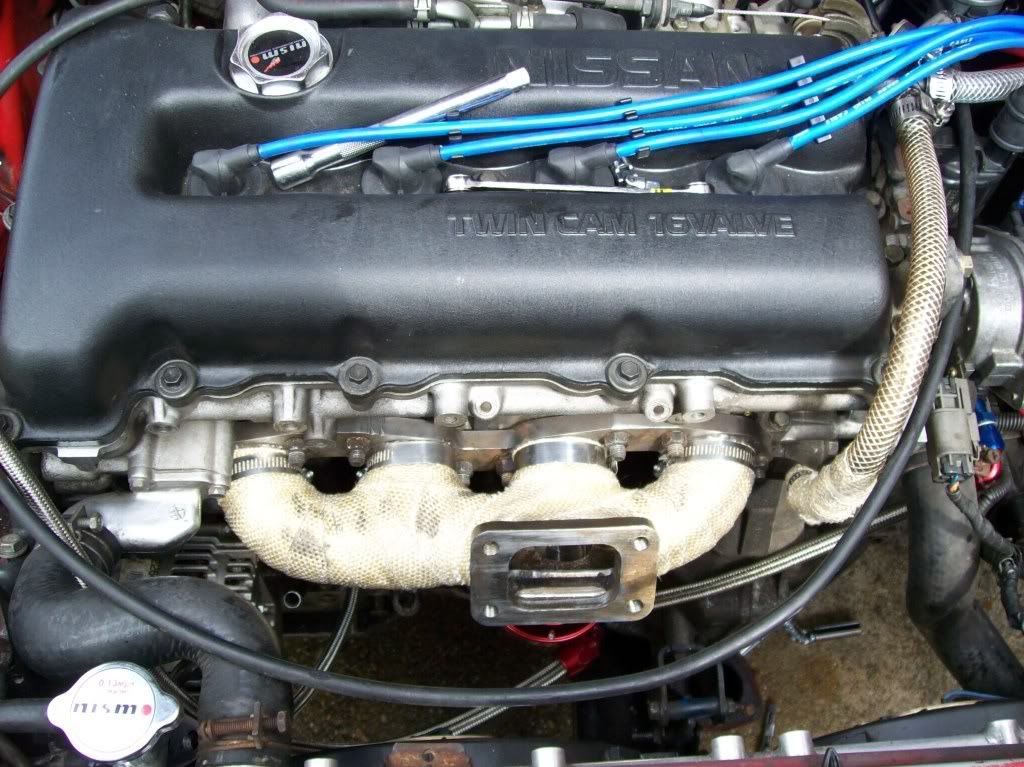

Found this one on SR20 forum....so I thought it was a good idea to with.....but now I think I must have something else.
Can you guys please tell me what should I buy because I already have a crap Autobahn which I don't wanna use.
So anybody selling some manifolds????

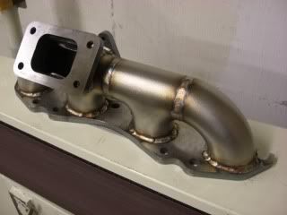

by the way the picture i showed was not a twin scroll evo8 turbo, below this is one.
