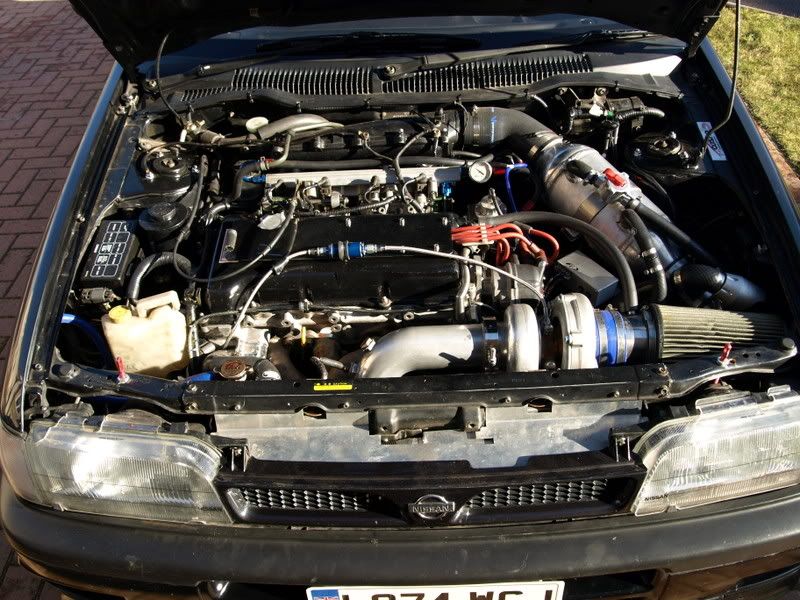

with regard to lag issues on the rally car....well in a nutshell im gonna
1)raise the compression slightly
2)fit vernier pulleys so i can play with cam timing
3) smaller tubby....disco potato
3) 3'' elbow and system all way through
4) smooth off combustion chambers in head and fit appropiate h/g to minimise any det
5)slightly open up water jacket and match block to head to aid cooling and try keep charge temps down
6) go back to tmic but modified arc setup which will be shielded from heatsoak by having an aspestoslux slate bolted to underside which should deflect heat away from rising into cooler
7) run methanol mix to aquamist bar directly above arc and link to brake pedal switch
in theory you need charge temps at minimum on apex of bend when coming back on the power, so if the aquamist bar is linked to brake pedal (which you would be using in order to brake for the bend) then by the time you hit the apex this should give the methanol mix time to freeze and bring temps right down
car will be running around 360bhp but hopefully should get through the revs very quickly if all goes to plan

maybe use an water/air cooler instead of an intercooler air/air ? could help a little bit, shorter pipe to fill pressure with.
Thats the chargecooler setup I was thinking of too, on Rob's old car.If you used the disco turbo you might be able to rotate the compressor and shift a few things out the way for an extremely short piperun
I am not sure about having the aquamist spraybar on a topmount.I tried a homemade version and it can fill the plugwells with water.Even if you seal them off it could still end up settling on something electrical.
Also, when you are braking are you lifting off the throttle?If you are, then it might give the mist time to puddle on the pipework as it won't immediately mix with the air.Most systems activate off boost pressure so mixing isn't a problem as the air is there already.I am no expert on WI but I am having it fitted myself and have done a fair bit of research the past few weeks.I have settled on keeping my ERL 2c kit(needs a programmable ecu) and upgrading it to a 2d with a pressure switch and an FIA2 controller which activates at a set pressure and takes a reading from the injectors and increases water injection accordingly.

I have looked into the water/air system for my setup but when you add the weight of the extra radiator, coolant in the system, and water pump you will be adding a minimum of 15Kg to the already heavy front of the car.
I tried the ARC topmount but for the races i race in and being in this hot country, i don't think it good. I stay at least 5 minutes idling (with ambient temp at 25deg+) at the starting line staging for my turn, and off I go for a 40 to 70sec run. I think the race is too short to cool back down the topmount. I now went for a N/D front mount.
Apart from the TMIC being exposed to heat, the engine being so close to it will also limits (to a degree) a proper flow of fresh air which can pass through its fins. Look at the boonet vents on an EVO for example, they create a sort a vacuum to suck out air aiding the flow coming in from the front. In fluid dynamics we learn that flow is governed by pressure difference (and restrictions) between both sides of the flow.
If it is possible to cool the TMIC by using other methods (as Bob suggested) It would be in my opinion a great setup.
