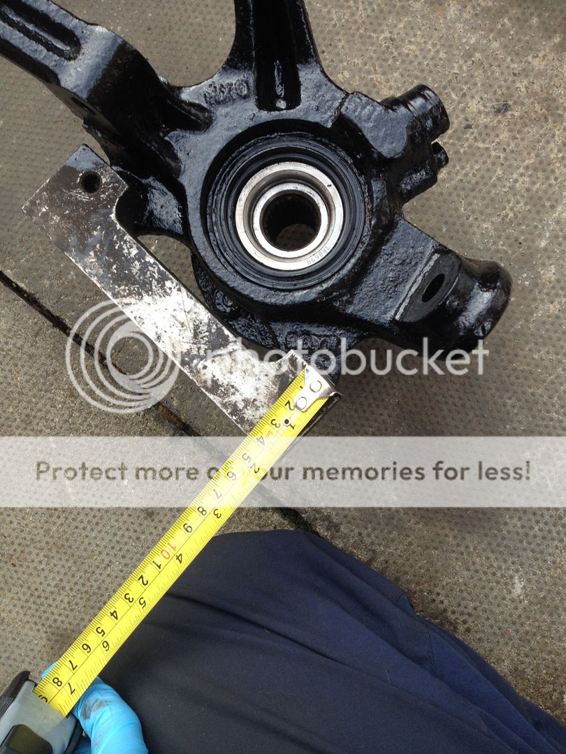

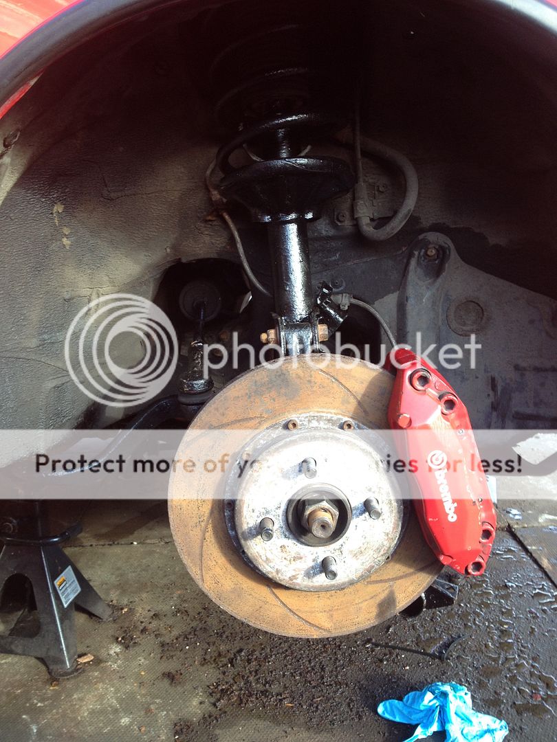

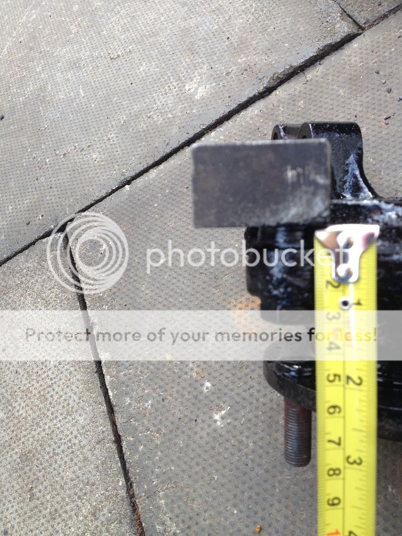

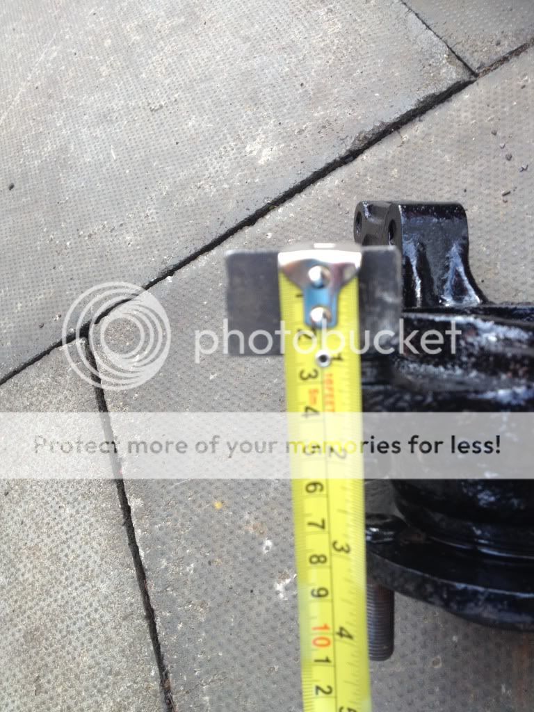

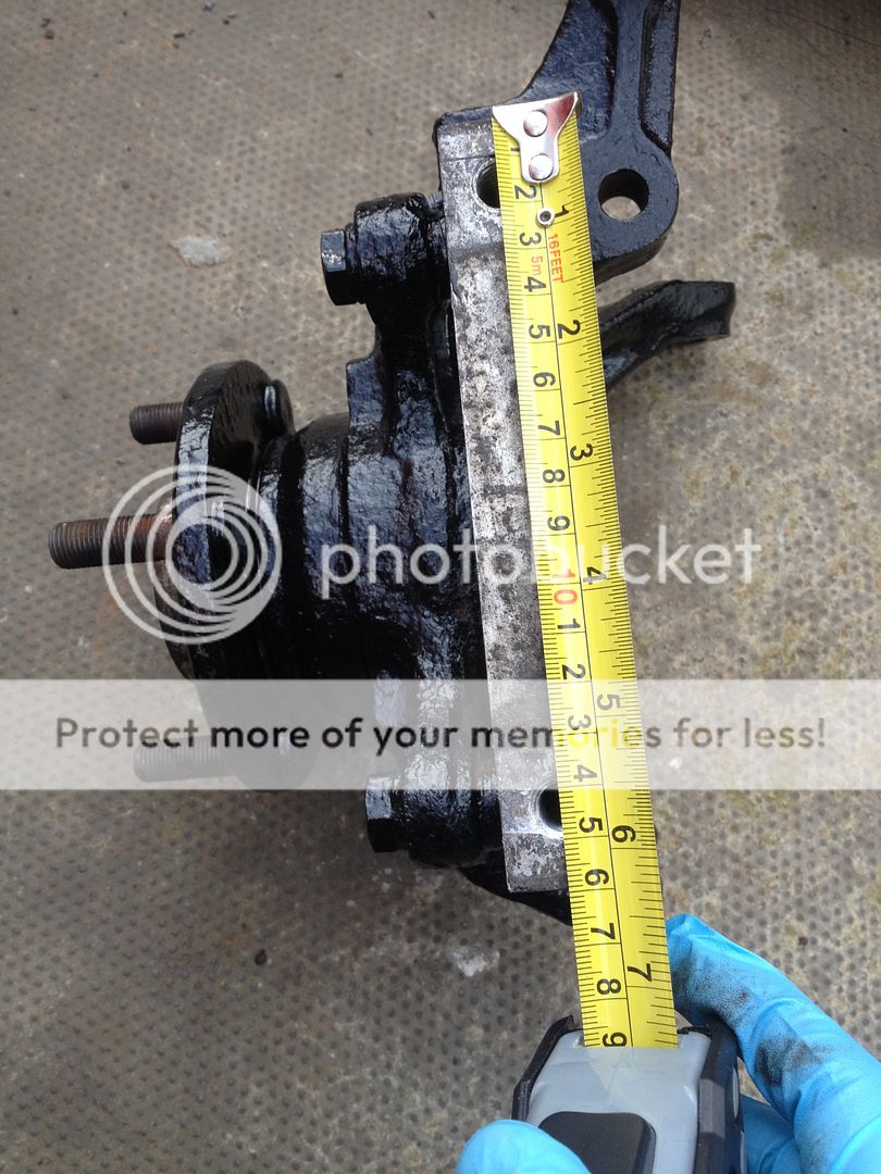

I'm in the middle of doing this conversion just now using new modified standard 304mm coupe discs, the Brembo mounting lugs don't appear to clear the pulsar carrier mounts for me to mock up some brackets, has anyone done this exact conversion before.
whytie
Forgot the size of discs I'm using but you get the picture, like a said on previous thread the hangers are very simple and can be made in no time
