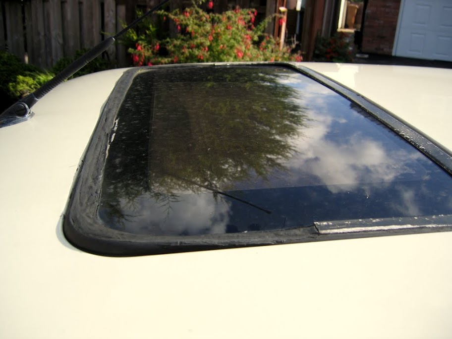

Anyone know how to repair the seal on the sunroof?
What about a replacement seal instead because I think someone's already had a go at repairing mine:
Just lately that corner has started to lift - I'm not getting any water in, but I can hear the wind noise.
I tried pushing it back down, but it doesn't seem to want to stay; like it's not gripping the edge like it's meant to. :doh:
So, any ideas/suggestions/parts?
grim_d
That looks in a bad way! half the trim is missing too. (why do they go that funny flakey way?)
Maybe worth going to Nissan for a new seal/trim if available, probably less hassle than messing around with used bits unless someone has one in really good nick.
While you are at it, if your sunroof is anything like mine, would be worth attending to the rust on the frame of the sunroof.

Yeah, I think I've already got that problem with the drain willing my quarters with mud, but around the sunroof its self is actually quite good. - I'm surprised you can't just get a new seal to go around it; it hasn't split or anything, it's just not staying down any more.

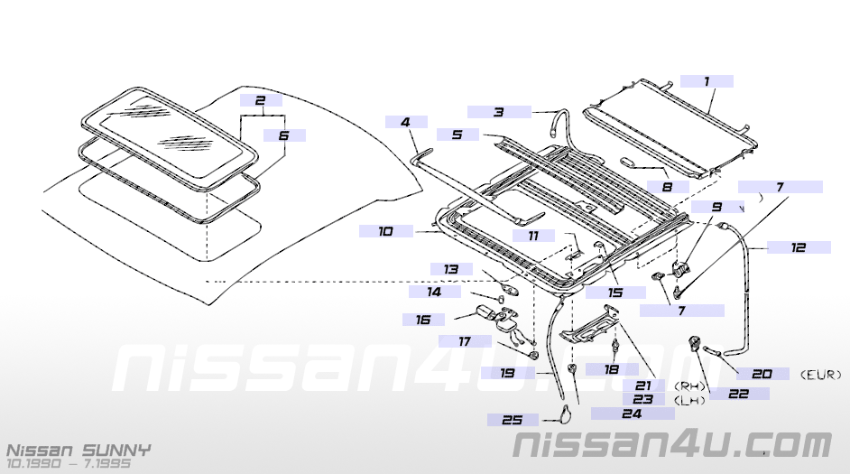

Is it possible it's the same as on a Sentra: 91246-50Y10 - That's apparently the sunroof weatherstrip, which I take to be the rubber piece that seals the roof.
pulsar_stu
number 6 on that drawing looks interchangeable.
it was the seal on number 2 on the drawing that mine was knackerd on.
