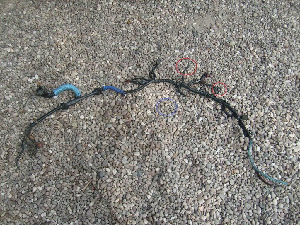

Ive got most plugs in.. struggling to find a place for the ones marked in red and also the one in blue, it is missing on this picture as this is my old loom, the plug is the same size and shape as the injector plugs that go on the inlet manifold.
Paul
Ended up taking the plenum off as I could see a white plastic mulitplug with no home, this was the knock sensor plug, the sensor wasnt even attached to the engine :doh:
