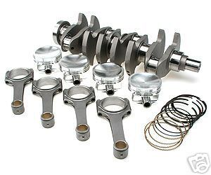

The cost of the 2.2 kit is roughly £600, the fitting of the liners is as stated approx £600. That equals £1200.
If you take out the cost of the pistons (cos you'll also need some if you do a "normal" rebuild too) that will leave £800-900.
It ain't rocket science.
edit.... if you notice , the 2.35 kit also has 90mm pistons but no liners...which you'd have to buy and have fitted .

a lot of the drifting and racing teams were futsing around with the 2.35 stroker kits here in the states . they just couldnt seem to keep head gaskets in them . they used cometic head gaskets , ringed the sleeves and head , they even tried using 1/2 inch head studs . from all of my racing experience i have found that the 90mm bore is just too large no matter the sleeves and treatment . at least to get to last one whole season . i have been experimenting with 88mm bores and 90mm stroke , the reliability factor has gone up dramaticly . and that sets the displacement a little over 2.25L . when even the major teams couldnt get the 2.35 kits to work i figured that it would be unrealistic for me to get it to work , so we junked it .

i was gonna go for this stroker kit, but what you have said is exactly what ive been told;-)
they are horrendous for blowing head gaskets when under extreme loads on the track!
and thats with dropping the comp ratio too.
like you i decided against it, as the extra power and torque doesnt warrant the unreliability factor.
never posted this before as people would have just slated me, but i personally think that the 2.2 kit is still too hot for the engine to handle, but thats my own personal opinion!

a stroker kit increases the stroke of the engine.
This kit isn't a stroker as it's increasing the bore size.
