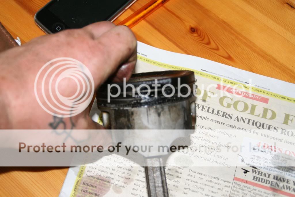

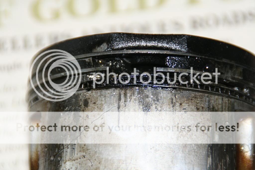

do a compression test though before you whip the head off as it will tell you a lot, dont just pull it off without carrying out a few basic checks first, but if the plug is oiled up on that cylinder then you know for sure that its more than likely cracked a ringland or damaged piston.
providing the bore is still good then youll get away with a quick hone and chuck another piston in it

right been to pick my new nightmare up today did about 100 miles when i noticed smoke when the bov released drove a bit more and it started missing so i pulled over and rang :boby:roadside assist and he talked me though some checks and he figured out that no3 piston has given up :doh: so looks like head off tomorrow and see the damage but for the money i paid im still smiling just lol thanks again bob

well piston out and ordered luckly my bore is fine ( praise jebus )

I wonder if this is what bob will find on my engine when i give it to him? Mine was down on compression on piston 3, did you do a test? If so what was your results?
no worries nath, do as said and youll be fine n dandy;-)
pete.....yes this is what you will find on your engine for sure lol
