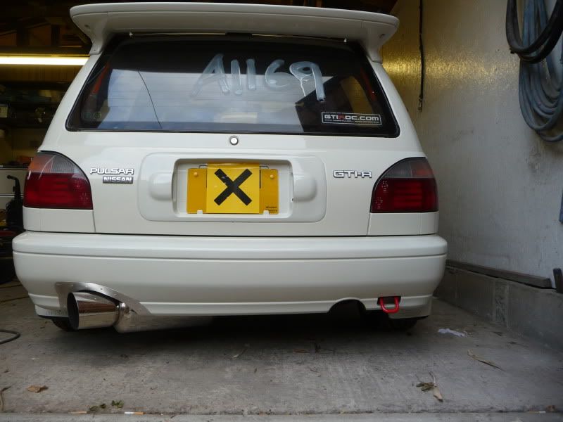

This is what it looks like when it exits on the other side (observant members may recognise the car, and know it's not mine):

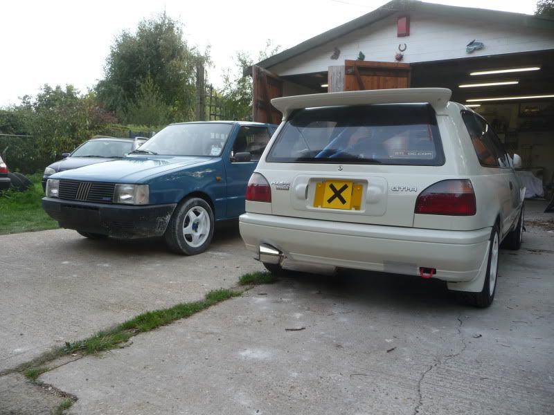

...and this is what it looks like with a twin-exit system:

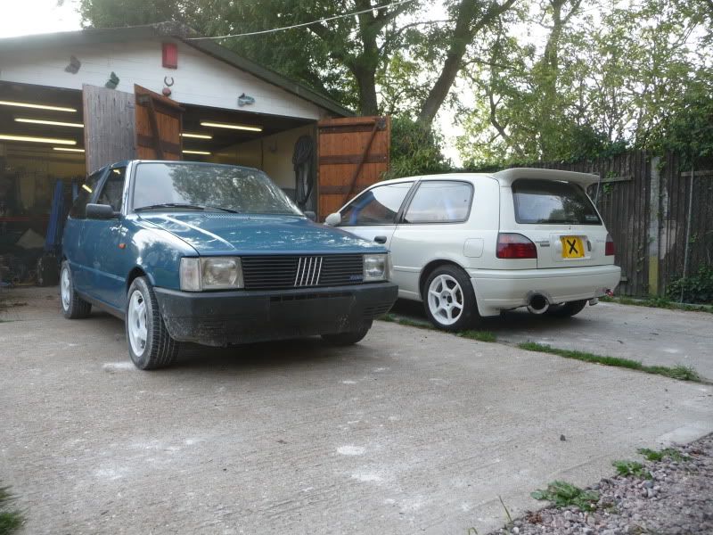

And this is what it looks like when it dont bloody fit:lol::doh:
