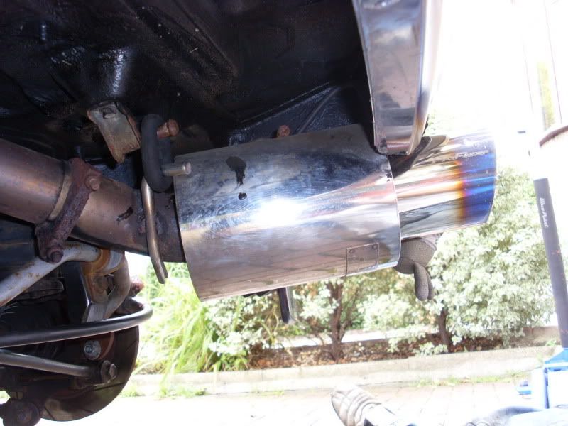

I put a hks dragger silencer off an evo on my goose,looks bloody terrible lol as it exits at a funny angle on the other side of the car due to its size,does the job though i spose.

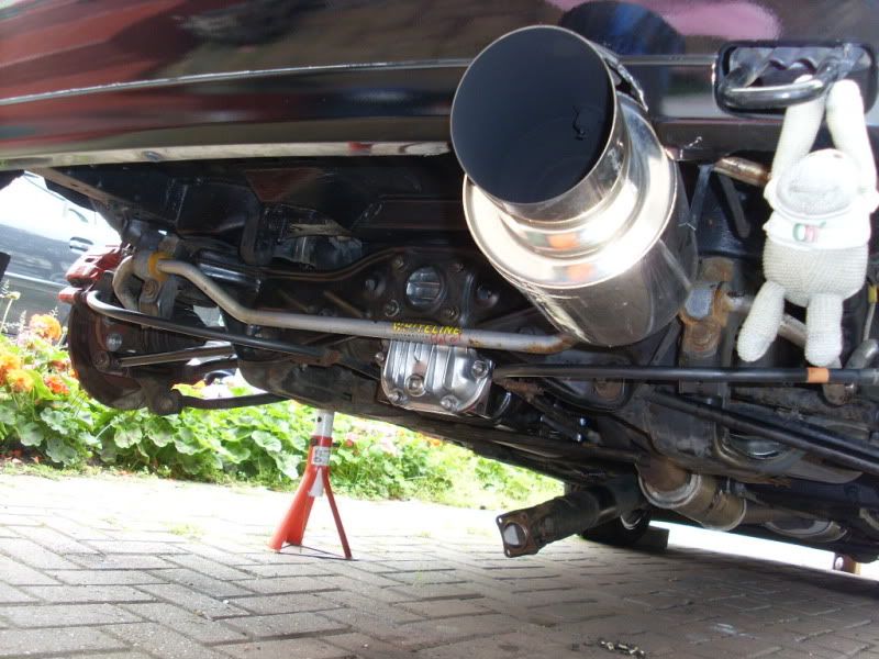

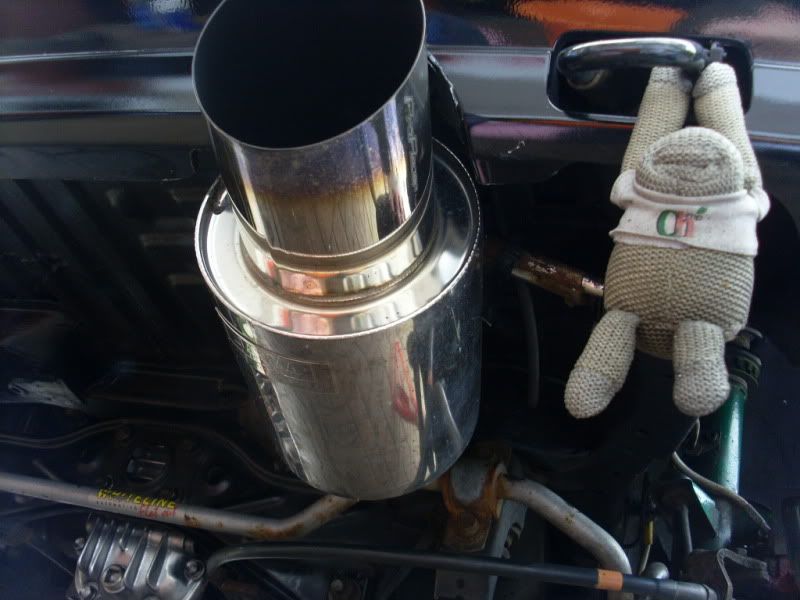

Oh ok. U got the box exiting on the right... Any problems there? Clearance ?
Original exits on the left?
Flamer exhaust and swinging monkeh!Two hit combo.
lol - I noticed that spark plug too.
There's also a second silencer in that system further down.

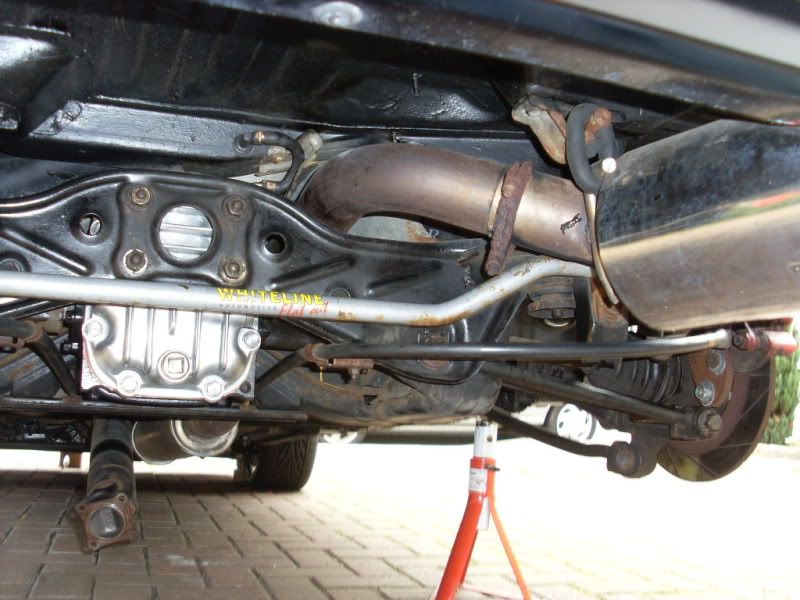

This is what it looks like when it exits on the other side (observant members may recognise the car, and know it's not mine):
...and this is what it looks like with a twin-exit system:

thats brilliant guys the pics made it a lot clearer!! :-D
