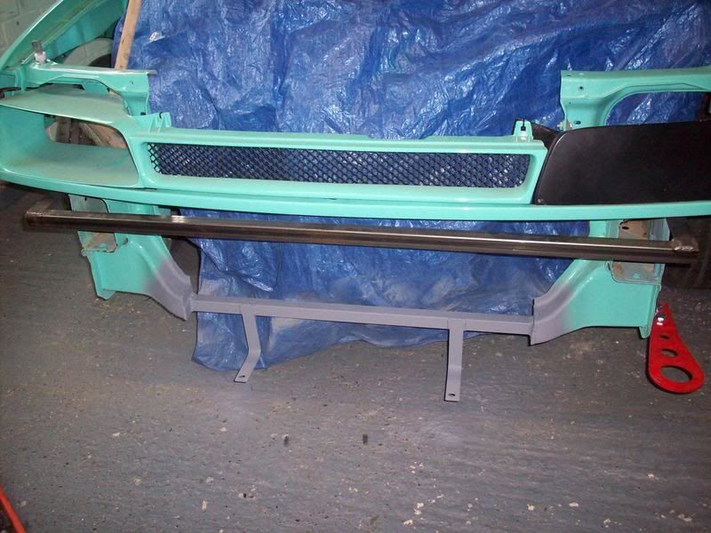

And whats the crossmember is that large metal pipe under the rad ???
and i taqke it the slam panel is the crapy metal bumper thing, my large front mount is connected to

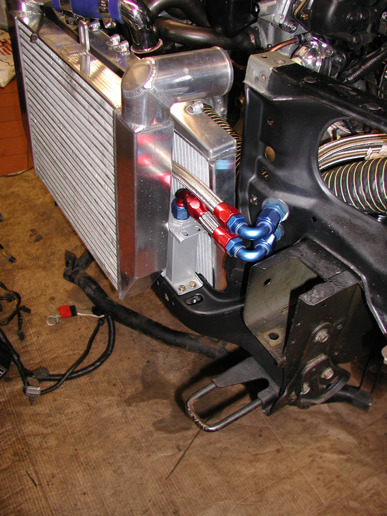

not sure on the size without measuring it tbh but the ic is very deep (much deepet than one of the ebay jobbies.
the slam panel is the metal strip thats bolted between the headlights mine is now gone, as is kierons above:lol:
ive even had to cut the back plastic fixings off the headlights to gain a bit more room for the turbo to clear the rad / ic unit.
if you look at kierons picture above at the bottom you will see where the front crossmember used to be:lol: ive not done such a nice job of mine but basically the rad and ic will sit on top of that bar in the middle.
you will also need to lose the horn bar and all the bonnet catch mechanism and use bonnet pins instead.
having said all this (this is based on fixing the kit with running a large tubby with 4'' intake) if you retain a standard size turbo then i reckon a radtech kit would be a straight forward fit

Trip said:
Isn't there that 'cross member' with the engine stabiliser on it .. How do you drop the radiator down with the cross member in the way ? :shock:
You remove the bit that goes from the tubular x-member to the main x-member...
the rad in the picture is a std sized radtec rad........

you lost me fella so what do i need to cut off to drop the rad/ does it involve welding as well..... is there no way to drop the normal rad with out having to cut anything, canot look at my car due to it still being at the Garage (only been 4 months now) :doh: :-D :-D
stumo
On the tubular x-member there's a bracket which attaches it to the front x-member, it's that bit you need to remove. wait till you got your car back and it'll make sense.

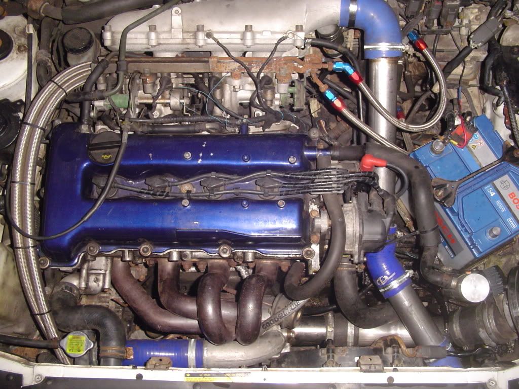

Theres far too much pipework in your average front mount kit, whenever i've driven a car with one fitted it feels a lot more laggy than mine.
This is what ive done on my car. The intercooler inlet/outlets are on the side as usual but at the top of the intercooler and the pipework runs through a gap either side of the radiator.
mark what manifold is that?
