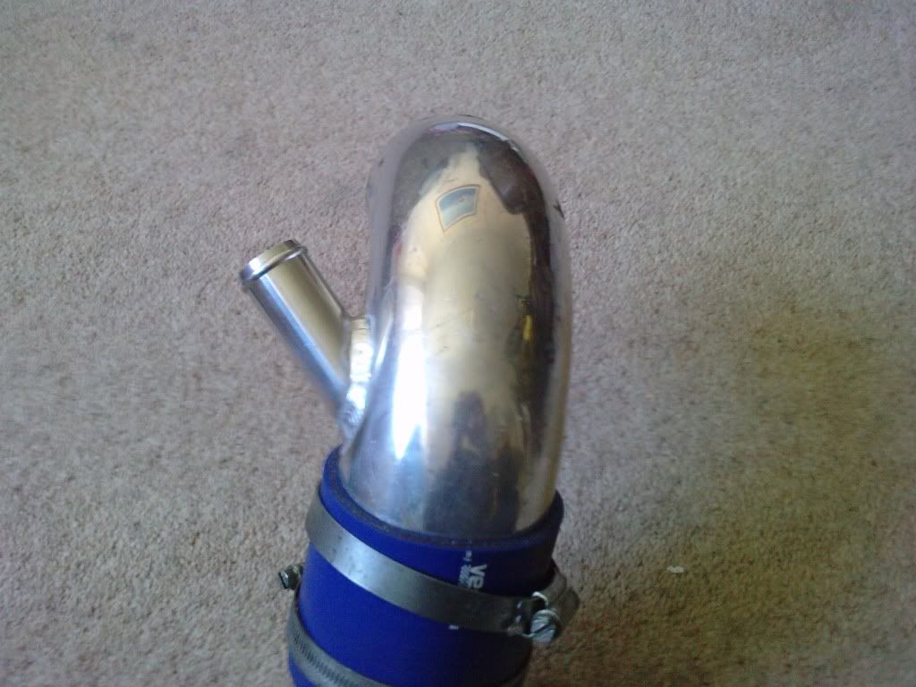

I had a bit welded onto my intake pipe for the recirc to come back in and had it angles so it would be going down towards the turbo rather than the filter.Things follow the path of least resistance so the only way its going to the filter is if it 1st bounces off the compressor.I don't see hwo that would happen though as the compressor will always want to spin and in my head this means its helping the lag between gears a bit due to forcing air into the turbo.
I doubt it will make much difference. given a choice of turn left towards equal pressure or right towards lower pressure, air will always take the lower pressure route.
Right(down) is towards the compressor on that intake.When you close the throttle does charge in the air intake(from filter to turbo) stay below atmospheric/go atmos/ exceed atmos?I'd have thought the comp will still be spinning a bit when you lift off the throttle so still sucking some air in and lowering pressure?
The intake between filter and compressor will go to zero pretty quickly I'd expect though I've never tested a recirc to confrim.
The compressor is still spinning when you run without a DV and the flutter noise you get is blades cutting through the air. The flutter noise you get from a posh 2-stage recirc is the same effect where the DV stays closed at low boost.
The logic that the compressor keeps spinning and forcing air in I don't get as the higher pressure air in the intake/intercooler will all be trying to get to atmospheric pressure no matter which way you direct the flow. Unless you run ALS then the turbine won't have any force to compress air either so you are left with.

Isn't the high pressure air in the intercooler and piping what is escaping through the BOV though, so that piping will quickly go to zero?If the air in the intake from filter to turbo is also at zero then pointing the recircing air towards the compressor should influence its direction.
Also, when this air is released through the BOV would it not briefly create some suction behind it, dropping pressure and further encouraging the compressor to turn?I am obviously not an engineer and my physics is probably flawed.
Not really; you can't think of gas being like a fluid. The pressure will always go from high to low, and as Jim says, if that means going back out through the air filter, that's where it will go... or into the rocker cover through the breather... or out through the catch can.
The low pressure is sucking the air back as much as the high pressure is pushing it forwards.
Obviously I'm coming at this from the perspective of thermodynamics, so have to concede that empirical evidence might be different.

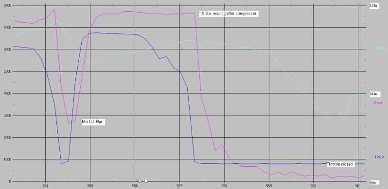

Williams asked me to dig out my logs. I found lots of typical logs with the DV removed and the sensor both in manifold and after the compressor in the intake but none yet that give a like for like comparison. For this issue, looking at the residual boost pressure between the compressor and manifold is most relevant.
For reference, I had a mechanical gauge in car with manifold pressure which showed a 0.1bar pressure drop across the intercooler.
My car uses a PACE intercooler with a short pipe run and a 0.63a/r 3071r turbo so response and lag are already pretty good.
All readings are taken from my PowerFC through a datalogit. Boost is controlled through the PFC. The PFC only logs every 0.1s so the chart is interpolating between readings.
In the diagram below you can see I come off the throttle at 553.5s and re-apply at 554.5 so at 1 second it is a typical gear change, I'm not trying to drag race.
Even without a DV the boost pressure still drops but without a DV it drops more slowly so that when I re-apply the throttle there is already some air remaining pressurised at 0.7bar.
I can't find a good comparable chart with a DV as at that time the my boost reading was taken from the manifold which drops to vacuum once the throttle closes. The intake system will still return to atmospheric pressure at 0bar.
I won't post it up in case it adds confusion. With my DV in place the boost reading went to 0bar earlier and faster but I can't confirm how much is due to the boost reading location and how much to the DV. Eitherway it was at 0bar when I reapplied the throttle. The response of the turbo remained the same with the DV in place so between gears it took 0.2s extra to pressurise the system from 0bar to the 0.7bar.
My car is not very laggy so you could not feel a big improvement in turbo lag but after many times trying with and without the DV I felt that no DV was marginally better.
The second gear change on the chart I've shown to demonstarte that even with no DV there is a hysteresis to get from 0.5bar to 0.1bar but after a 2s gear change it doesn't matter if you run with or without a DV, you will start from a similar level of pressure in your intake.
