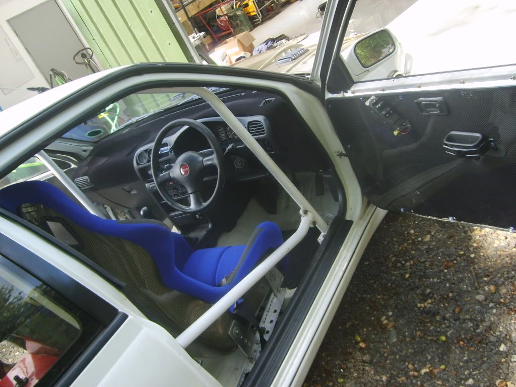

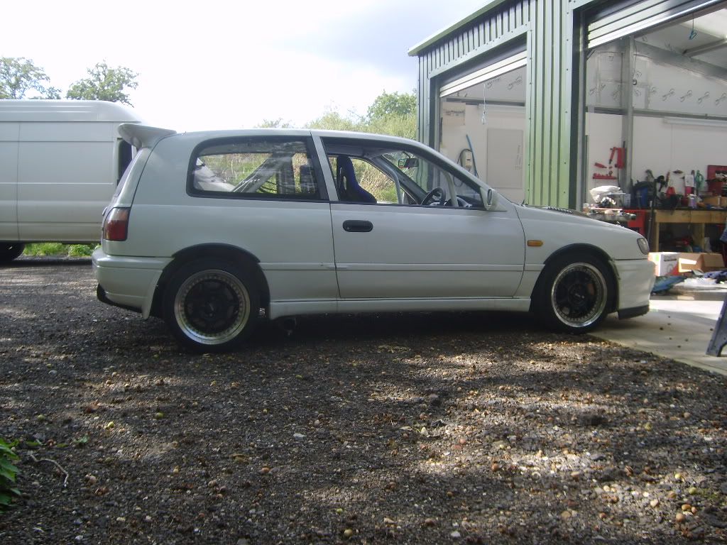

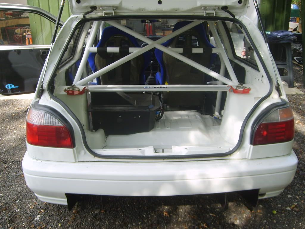

the fusion car (whats left or it) is the one under the blue cover in the pics, and yes the wheels are genuine split rims.Looks great mate! Loving the arbon door cards from the old fusion car! Nice looking wheels as well. They genuine 3 peice?

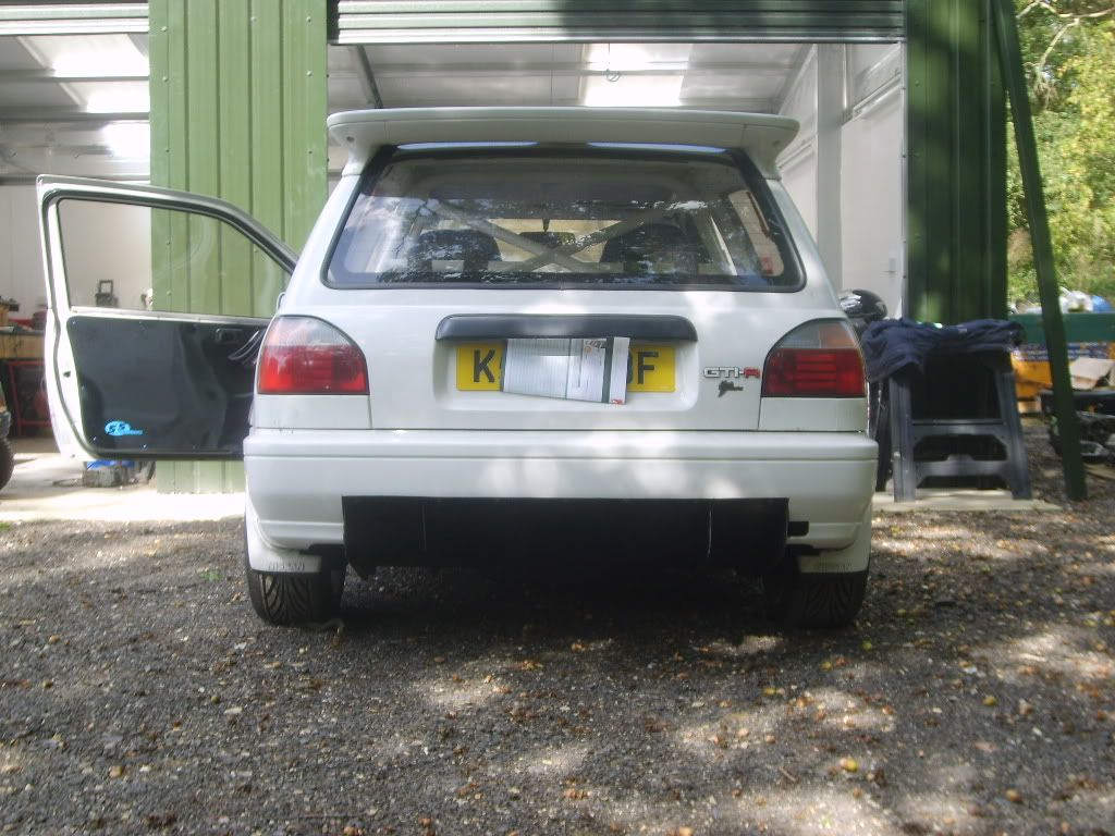

yeah it's one of phils diffusers,but as i have got a side exit exhaust i cut the bumper out and moved it up further.Looking very nice ;-)
Is that one one Phils rear diffusers?
One thing i dont like! is the cardboard beside the rear number plate! is that for down force?![]()
Are the handbrake cables still on top of it?yeah it's one of phils diffusers,but as i have got a side exit exhaust i cut the bumper out and moved it up further.

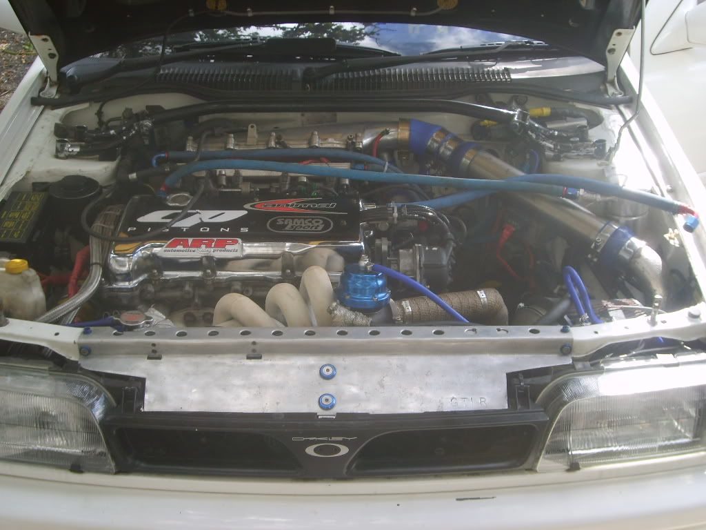

I got the car as a bare shell (the previous owner had bare metal'd it and seam welded),the specs are :- nismo fr/rr/centre diffs, par/ppg/quaife gearbox, poly bushed the entire car, nismo tarmac wheels, fully built engine ( 5 angle valve seat's, ported head etc) with gt3076r running 1.85 bar boost and 500bhp, proper fuel system with aero quip lines and bosch 044 pumps, 3" exhaust made by me (side exit), 4" inlet with K&n filter, whitline fr/rr arb with custom rear drop links, bc coil overs,brembo calipers and 310mm front discs, 285mm rear discs, uk sunny lager diff cover, powder coated subframe etc. kevlar seats,6 point harnesses,The car looks good, and i'd say you have spent a lot of money to get it to the point it is.
Nice garage by the way, most of the pics i see from the U.K people dont seam to have good sized garages.

Whats the 35/40 like on your car then? i'm interested in them ,was also thinking off either doing a compound turbo or supercharger /turbo setup next on mine.

3900rpm thats good, what a/r exhaust housing are you using on it then?I wouldnt know mate, We are still running everything in. Boost comes on about 3,900rpm though. No huge boost through it yet though.
