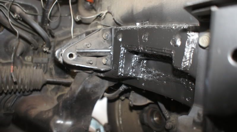

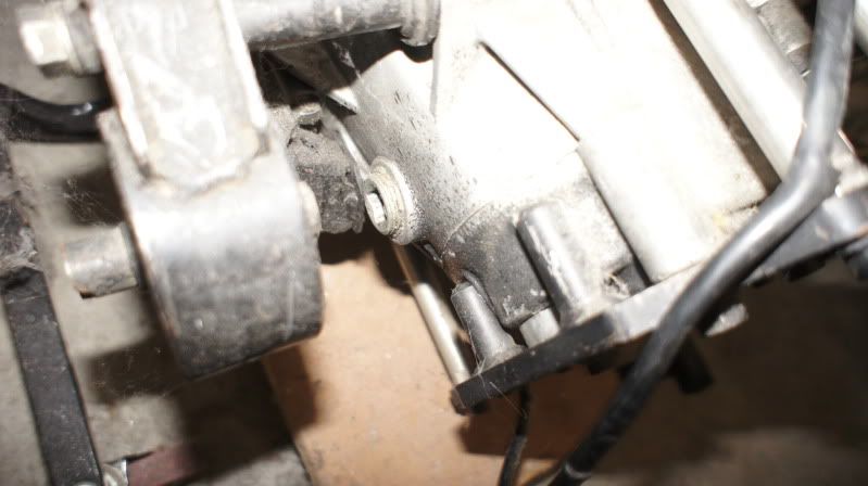

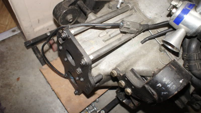

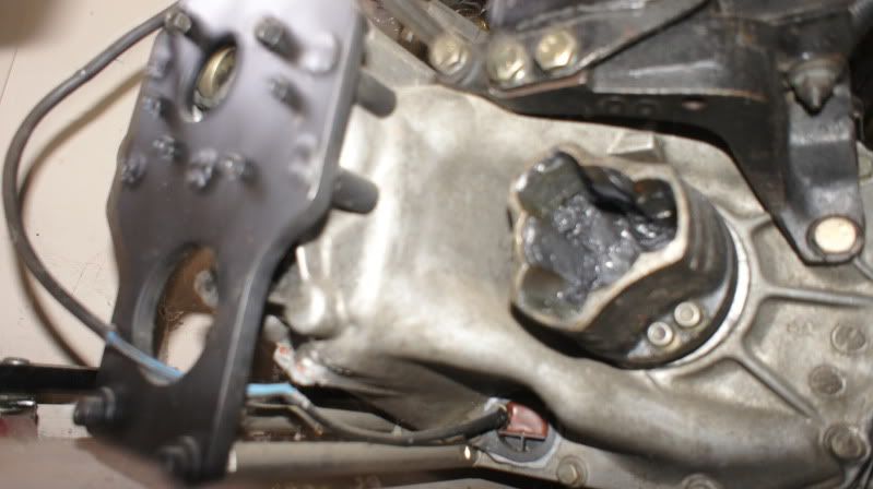

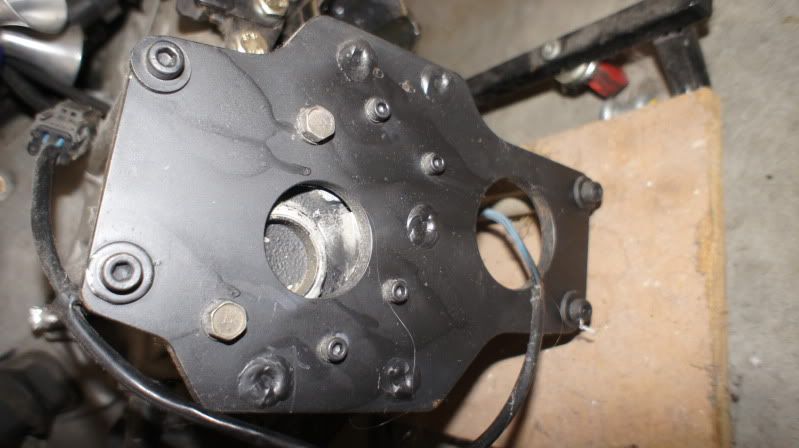

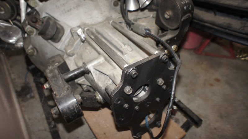

I'll start wil the gearbox bracing that has we have just made. I know you are in development of such a thing so you might find what we have done somewhat interesting. As you can see from the pictures below we have machined small groves into the gearbox casing for re-inforced fingers to hold the casing in place. What you cant see in the pictures is the aluminum block that sites between the steel plate and the gearbox housing to absorbe some of the pressure from the box. The rod connectors are made from stainless.
Unfortunity on the first attempt to fit it into the car the brace did not fit and hit on the chassie rail. So a section was cut out and then re-inforced.
It now fits.

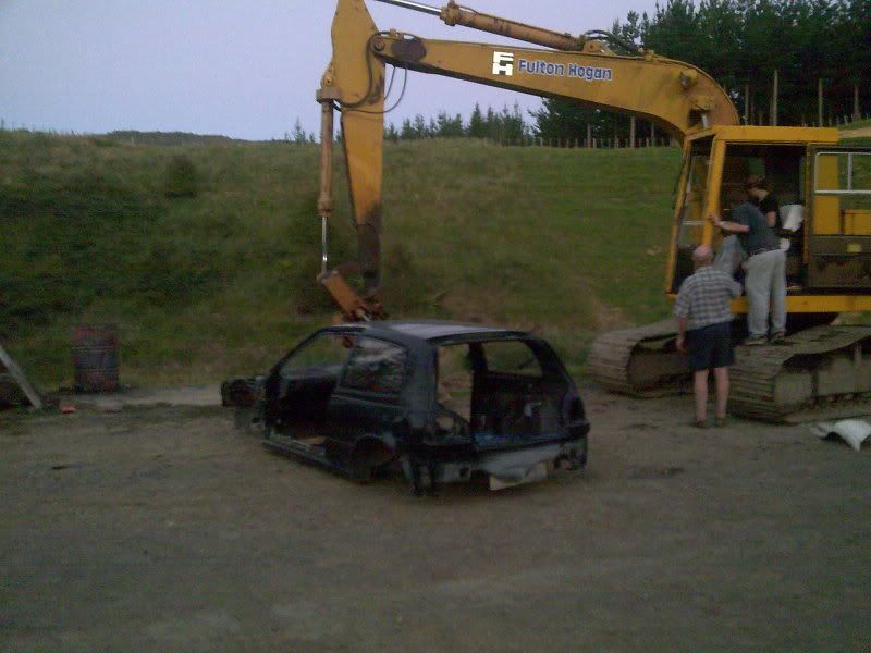

Whole Gti-r Shells lying around i mean what else would you do with them. Merry christmas
Why you'd let your mates crush them with your digger wouldnt you. What great christmas parties reg threw.

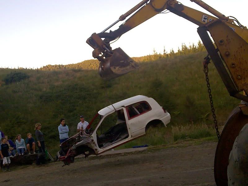

This one met the same death as the top one. Along with a 280z that night as well.

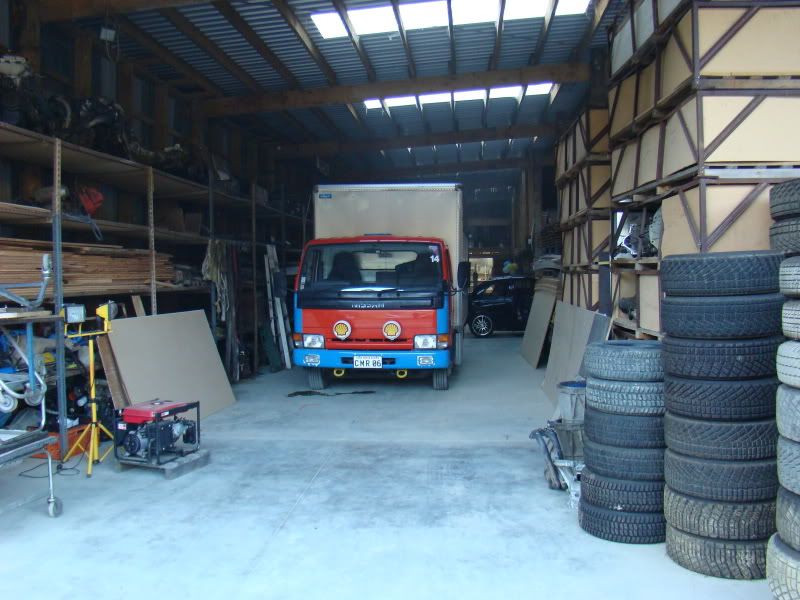

The storage end of the CMR workshop, if you love nissans CMR is like something from a childhood dream..each box and cointainer holding some rare part that you could only dream of finding or owning.

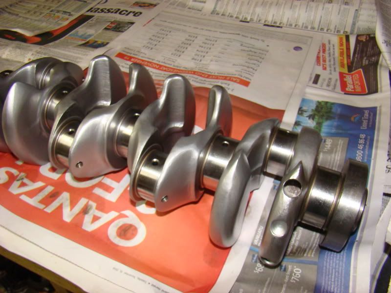

One of the cranks reg knife edged and prepared for my race engine

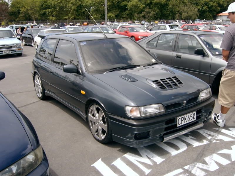

One of the top show cars in New Zealand for many years, this car has been on the circuit for over 10 years. But its kept in great condition

that brace is very similar to the one 00sid made a few years back, only problem is the shafts pull apart laterally and that does not strenghen the lateral casing.
the only person i know that got round this with a great idea was kieron aka ''yellow weapon'' by making a bracing collar on lay and input shaft but you had to lose fifth gear.
i was in the process a while back of making a cheap alternative to the above which i actually tested it also strenghened the case laterally and seemed to solve the problem.... but i never put it into production as i fcuked up and had the same troubles you had with the brace hitting the chassis....i then got put off the idea by kieron actually who advised me that by doing what i was planning i would only have a problem at other end of casing (bellhousing end) ie the torque would be transferred back there and end up punching the shaft and bearing through that end so i thought bollox i cant be assed with redesigning the mould i had already made.

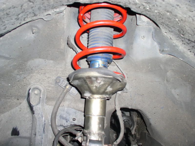

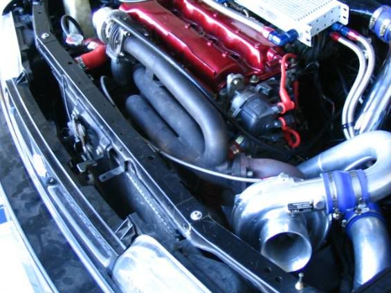

We then actually fitted some decent parts

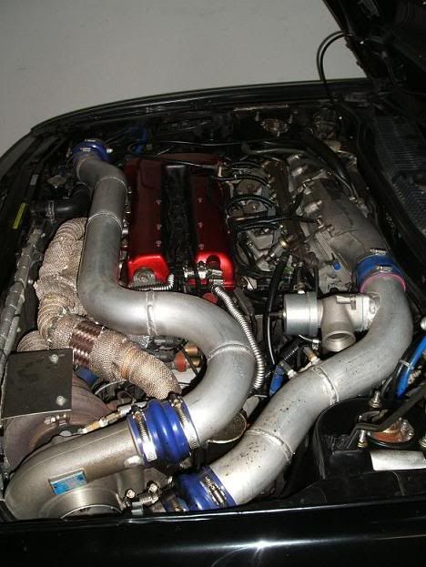

Ohlines suspension, GT3071R turbo ect. The car was close to 500hp.

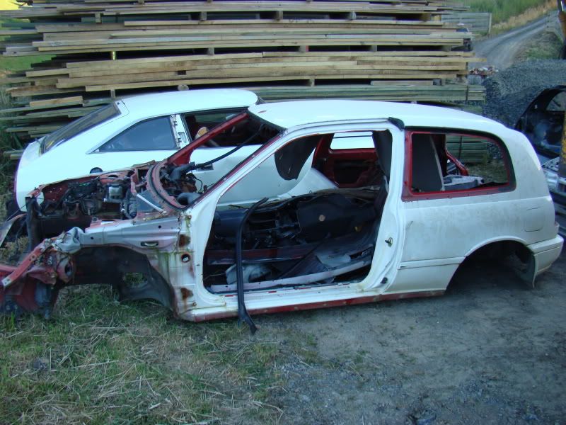

No loss though. As i had another in the build. I purchased a very broken shell.
To cut a long story short this is what it was when i got it.
What it was at the start of the year before i pulled it apart again.

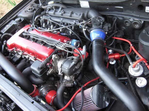

I have just got hold of a few of billy's parts on here. The 6 pot front AP racing brakes and rotors, carbon bonnet, cabon spoiler, I bought carbon wing mirrors Danny, Carbon Grill. Once the engine is back together and we are running the aftermarket ecu i am hoping for around 600hp out of the car by the end of the year.

We have welded splins inside the gearbox above and it is only a 4 speed gear set. :)
Very nice, i suppose i best get my arse in gear and post some pics up of my car now as it has changed alot since it was in total nissan, I like the brace i will pm you regards the layshaft bearings
