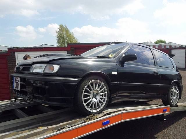

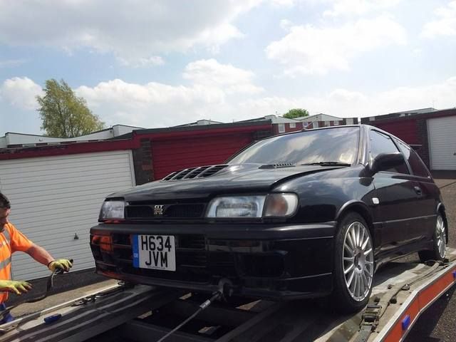

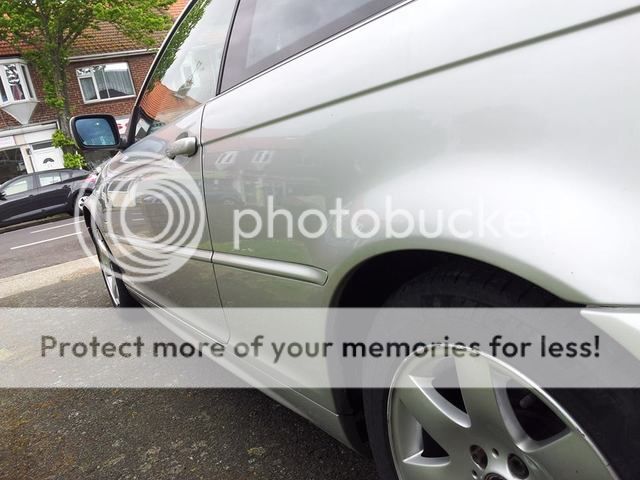

I became the proud owner of a tired old dog of a GTiR in May 2014. I saw the ad on ebay and put my 325ci BMW up for sale straight away.

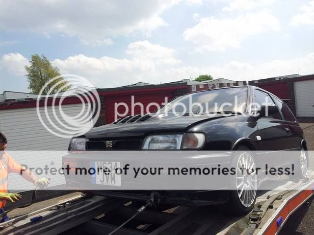

I always dreamed of owning a Pulsar but i didn't have much money or space for it, although that didn't deter me. So i found one on ebay in Newcastle. Ebay ad said it only needed a new piston which was supplied with the vehicle. Of course alarm bells were ringing... but it was a complete car and i didn't care! 3 days before the auction ended i sold my BMW for £900 quick sale and bidded away. I managed to win the auction for £850!! So after convincing my dad to give me a lift 350miles up the country to buy it and a towing company £230 to deliver it. I owned my first GTiR.

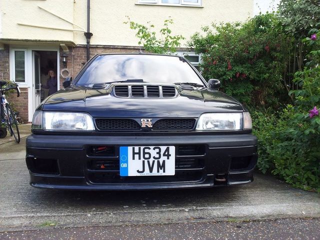

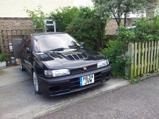

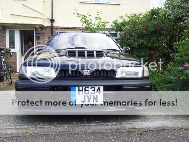

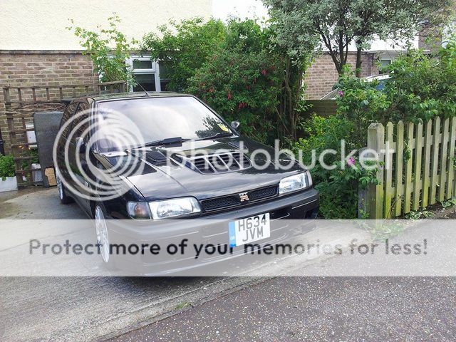

I promptly delivered it on my unsuspecting mothers driveway (unused) ...most of the time

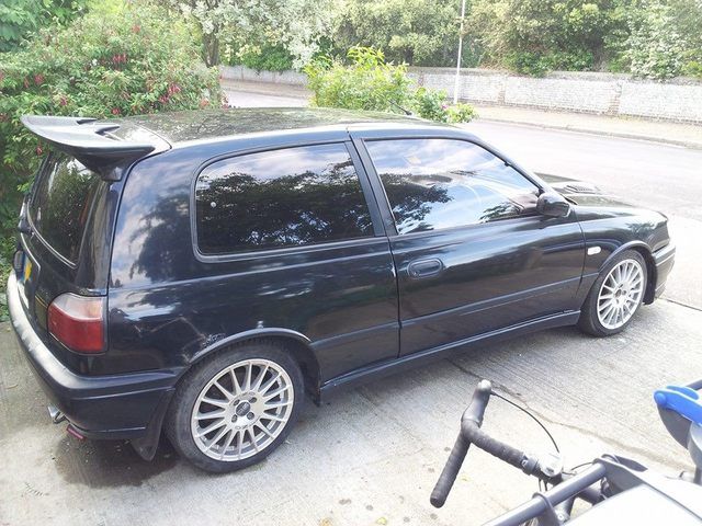

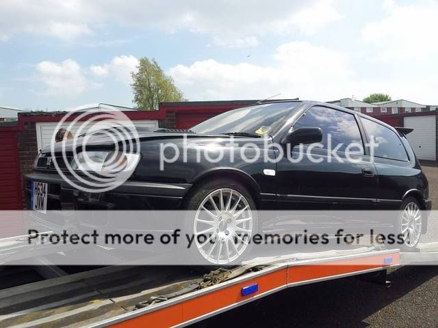

Here we can see her giving the expected disapproving looks from the front door, but undeterred i continued to take pictures of my car

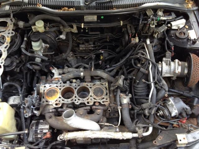

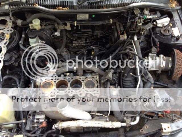

Take note of the dent in the pillar of the drivers door! I got pretty scared when i saw this paired with the broken off ignition barrel and mess of wiring underneath. The only explanation i have is someone keeping gerbils in the steering column and the RSPCA attempting a rescue. Any background on this vehicle btw would be a blessing. Because judging by the information to follow im going with it being a donor car.

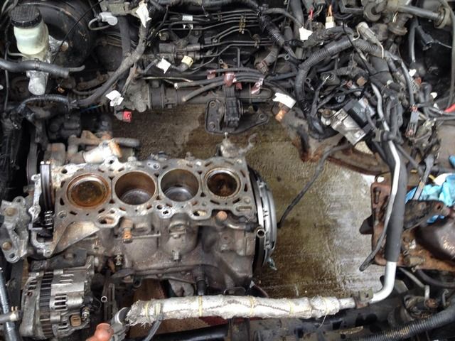

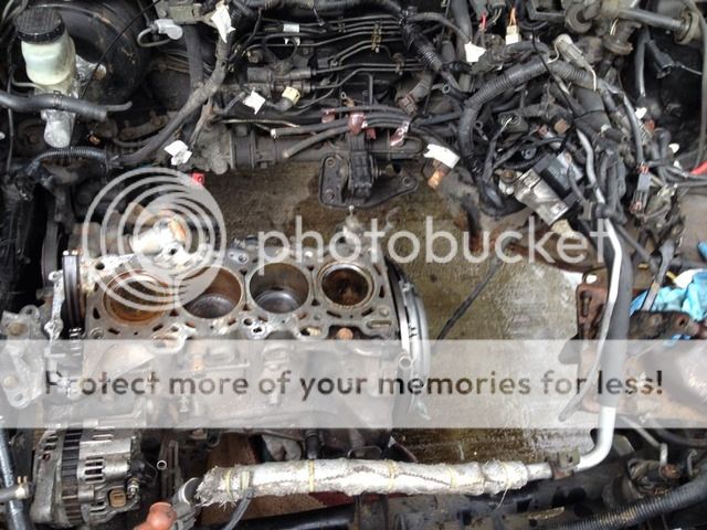

You be the judge. (it only needed a piston)
First impressions can be deceiving

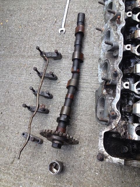

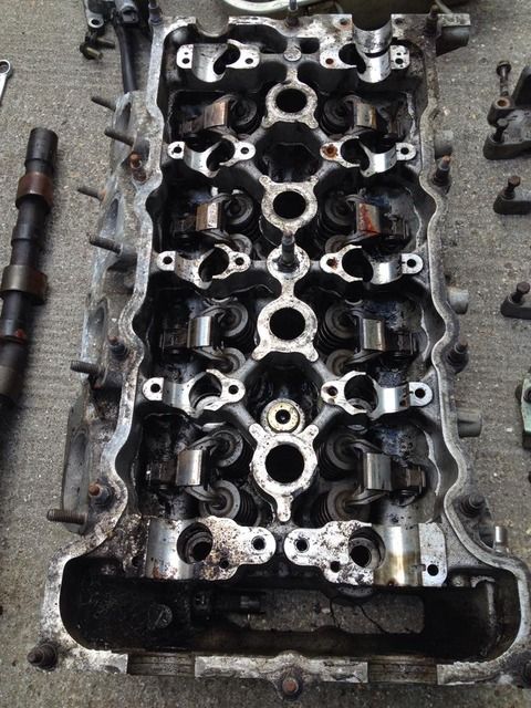

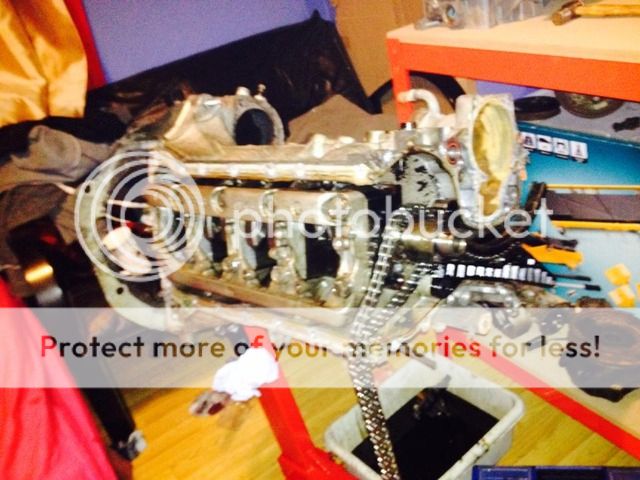

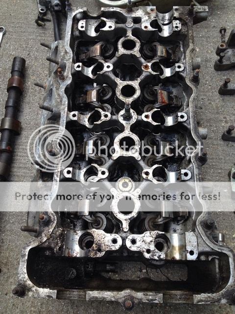

A little further stripping out before looking at the head.
OH BLOODY HELL CRIKEY!!
To say the least i left that day feeling a little overwhelmed, but do not fear, i still have the replacement connecting rod and piston (rod and piston from an s13). I've done a little bit of research and the normal sr20det and transversely mounted 54c/RNN14 are so easy to mix up. He obviously realized and jumped ship.

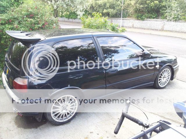

But this is my car now!
More posts to follow
Jon Olds
Was cheap enough, I suppose. I have a spare head, if you need it. If it were me, I would have the sump off for a good 'looksee' before spending any cash....

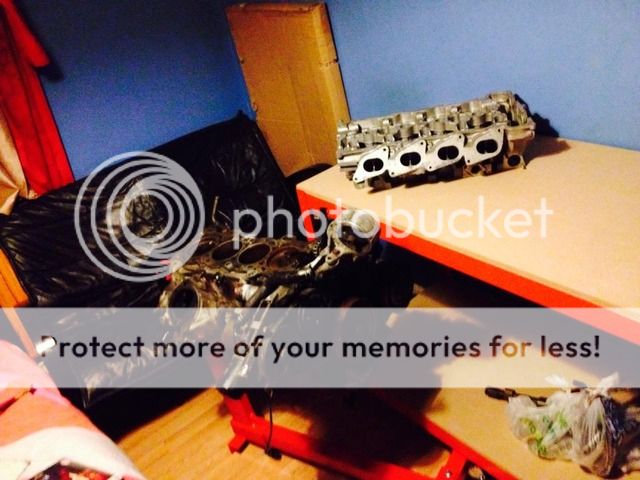

I've just come back from a year in AUZ and have spent a whole year itching to get my hands back on the car.

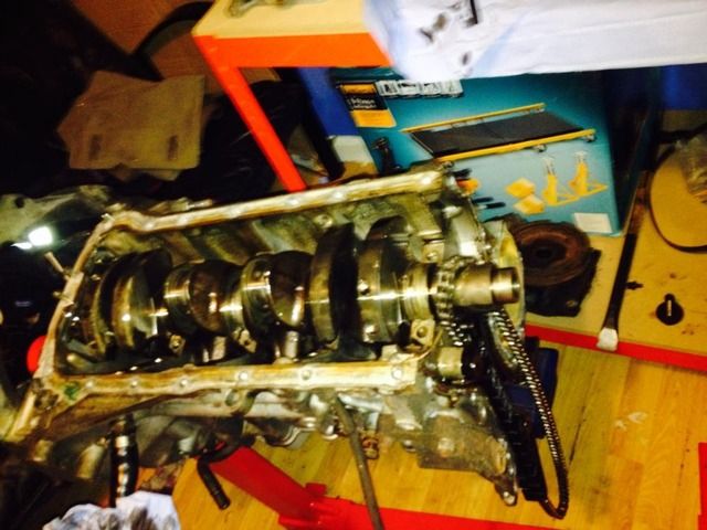

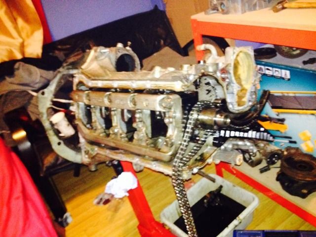

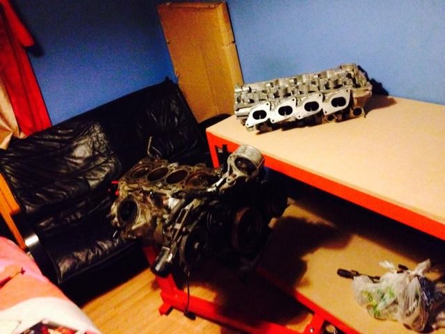

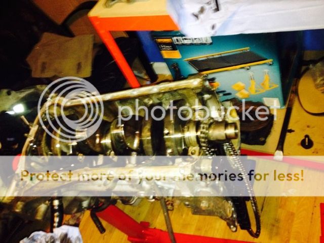

luckily i managed to get most of the gory bits out of the way like stripping the engine down etc before i left.
As you can see it was done in the comfort of the bedroom :D
I bought some new ACL bearing for the bottom end and test fit them with plastigauge but it seems i have a little too much oil clearance.
So, out of impulse i purchased some 0.25 ACL bearing's.
I bought myself a Dial Bore Gauge and Micrometer set which are waiting at the post office to be picked up. I'm sure plastigauge is a reasonably sound method but if i am going to need to get the crankshaft reground i just want to be sure!
I'll measure it all up properly on Tuesday when i have a day off and find out what's what.
I've also got all the goodies waiting to rebuild so as you can imagine Australia was an extremely difficult year :grimacing:.

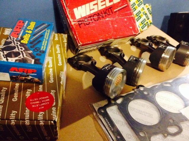

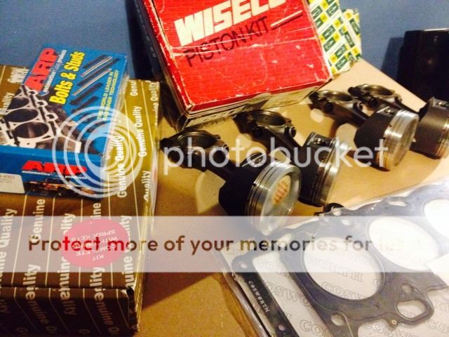

So far the list of goodies are as follows:
ARP Headbolts
ARP Con-rod Bolts
Wiseco pistons
ACL Mains Rod and Thrust Bearings
Cosworth 1.8mm Headgasket (the machine shop had to remove more from the cylinder head than previously imagined)
New Nissan waterpump
New Nissan Chain tensioner pulley kit
New Nissan Oil Pump
Full engine rebuild gasket kit
... i think that's it!!
