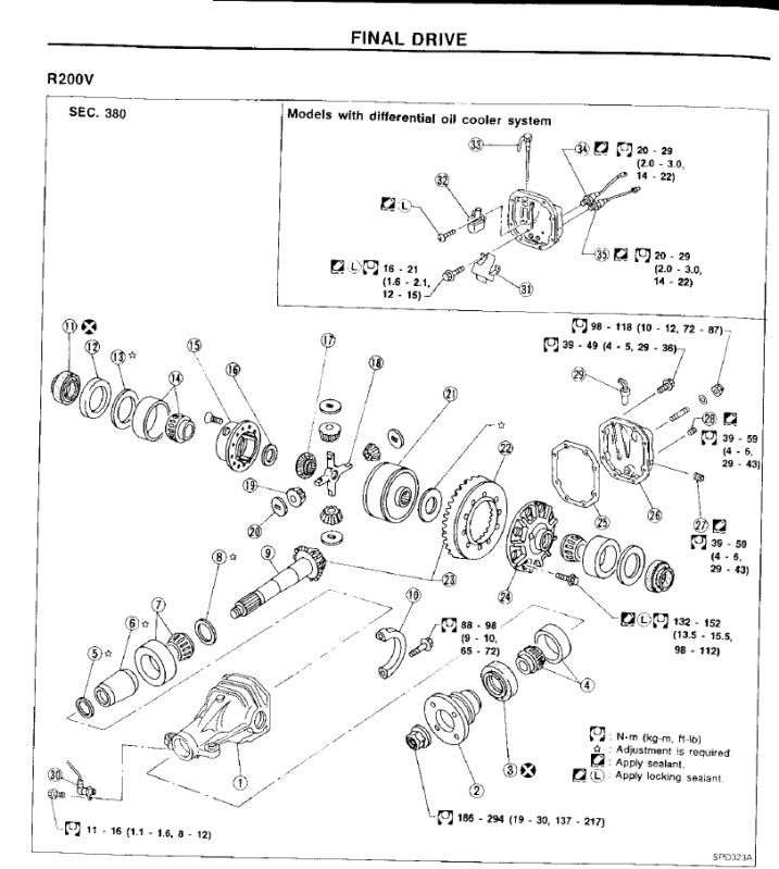

Now, the thing is that our diff is an R180 and not a R200 like the S14 has, but I investigated further and found this:
This is the R200V diff scheme:

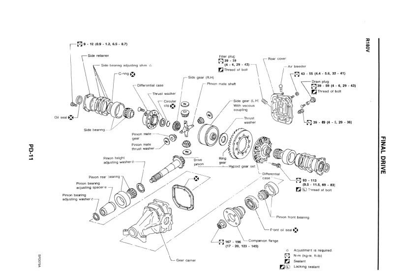

And this is our R180V diff (I don't know if GTIR's were made also without LSD, if they were, this is not useful for you, sorry):
They are pretty much the same, so if that shim works on the R200V, it has to work on ours.

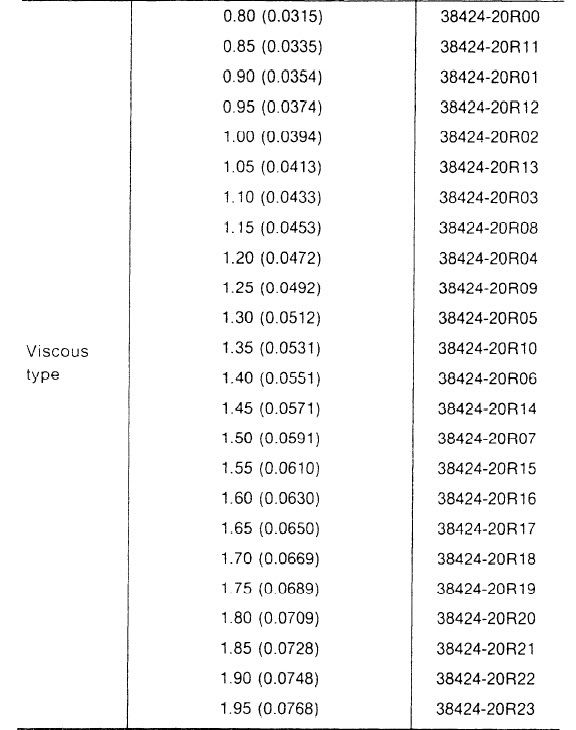

These are the sizes of shims that have to be used and the part #'s aswell:
