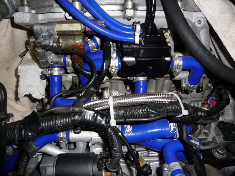

rear engine pics.
You will need the spring as that is what stops the hose collapsing from the suction of the water pump when the system is cold and not pressurised , if nissan state a delivery of over 3 weeks chances are it is not made any more.

Why can't you use the spring out of your split pipe & swap it into the samco hose?
Thats what I done on mine this weekend, presume that's the done thing?
Amber performance was a 4 week wait as well but beat nissans 6 week wait & you don't want to be doing them again so I would vote samco's.
Bit of a pig to reach when in the car.
Are you going to block off the water feeds to the inlet manifold while your doing it?

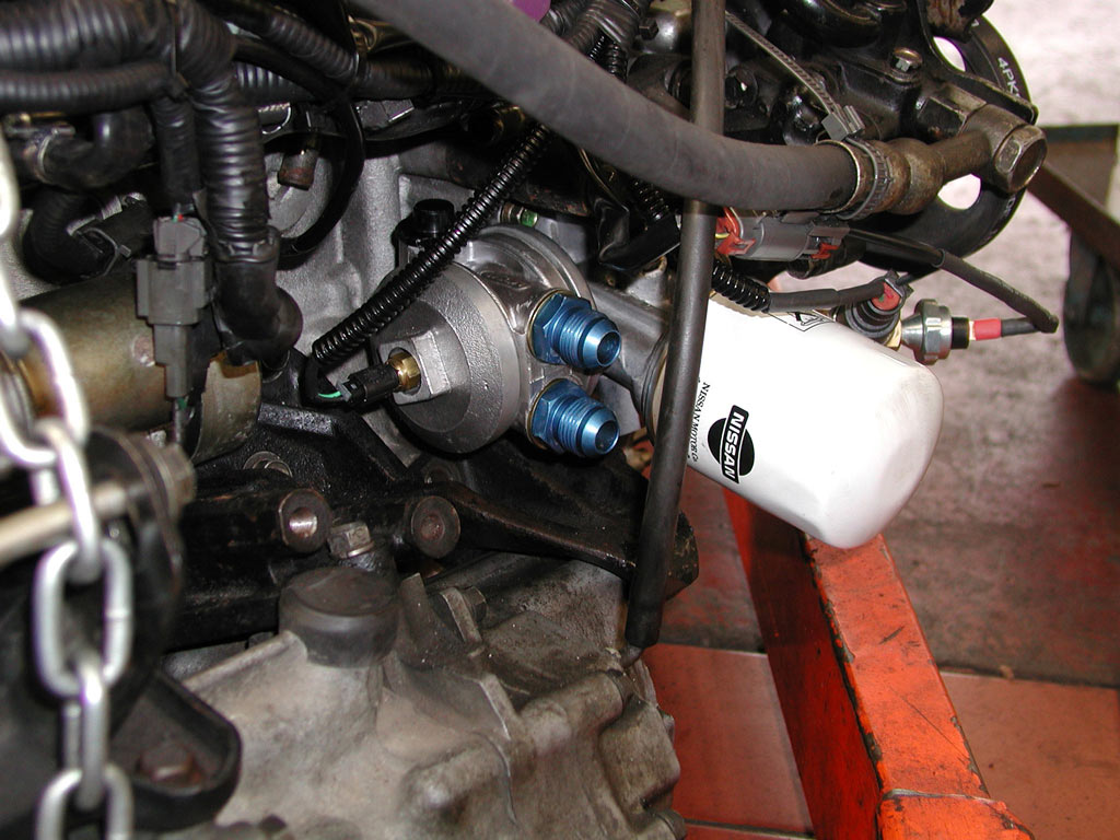

Just an aside, myself and Stumo moved the oil cooler to the side of the adapter and replaced the water/oil heat exchanger blocking off appropriate pipes etc. The reason being I kept getting sealing issues on the filter/cooler adapter plate as the oil filter holds it all together and over time was coming lose. It further simplified the back of the engine and meant you could install a bigger oil filter from another Nissan. I can't recall which one but it looks about 50% larger than OEM GtiR.
I guess the standard setup helps with cold start and attempts to exchange heat to the water system from the oil system when it gets hot but like others I found it inadequate on track.

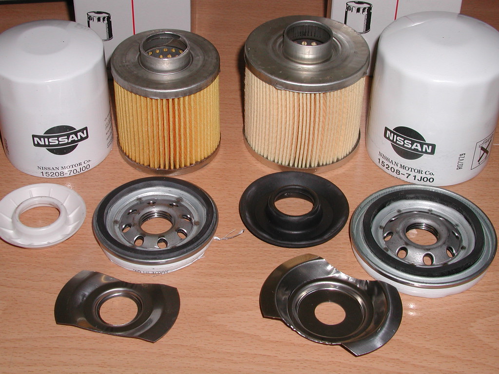

The larger filter to use is 15208-71J00, there was a thread on here aaaaaages ago where i worked out the areas of each filter, anyway here's a pic of the two filters...
and here is a pic of what Jim was talking about...
