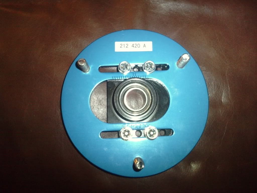

rear Adjustable Pillowball camber plates
I bought these that were supposedly for the rears but turned out to be for a sentra or something.Looks like they can be made to fit but it was too late by then as needed the suspension on.

Aren't they for the front?
I would imagine the amount of adjustment at the rear using the topmount is going to be pretty minimal anyway, get camber bolts or elongate holes in the strut or hub.

If set correctly and not played with constantly Whiteline camber bolts can be fine for a road car, I most definitely wouldn't want to use them on a track car though, it's also quite common for them to loose there adjustment due to the suspension banging about on our amazing roads. In my opinion adjustable top mounts if you can afford them would be the the most reliable option.
