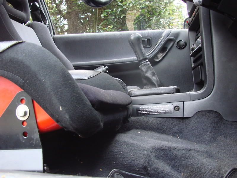

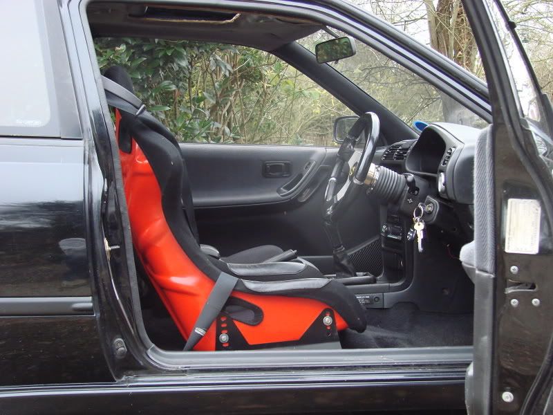

Earlier in the year I had the opportunity to get a load of "those nagging jobs" that needed doing to the car done, one of the jobs I did was to strip the carpets and seats out so I could fabricate and weld in sections of new floor pan and replace the front chassis rails. So with the standard seats out the way it seamed like a good time to try and fabricate some mounts and try fitting the seat that was now gathering about 4 inches of saw dust and metal swarf in the corner of the workshop. It was tricky to get the mounts into a position that allowed the seat to sit low enough on the floor and still be able reach the pedals when actually sitting in the seat.
In the end I made some mounts that allowed the bucket seat to sit about 40mm lower than the OEM seat, brilliant I thought, until I sat in the seat and realized that even in it’s lowed setting the steering wheel was now to high. Time to get the grinder out.
In the end I managed to get the seating position about 40mm lower than standard and steering wheel another 30mm lower than it’s lowest setting. This is great as it now feels much more like your sitting “in” the car, much better driving position than standard.
So in short, if your going to fit bucket seats make sure you get the seat low enough, otherwise you will totally ruin your driving position. I think the best fitting seat rails are the Bride ones.
Heres a few pic’s
as you can just about make out the new seat is 40mm lower than the passenger seat :-D

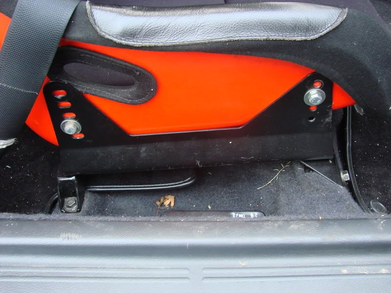

this one shows 2 of the fixed mounts I fabricated.

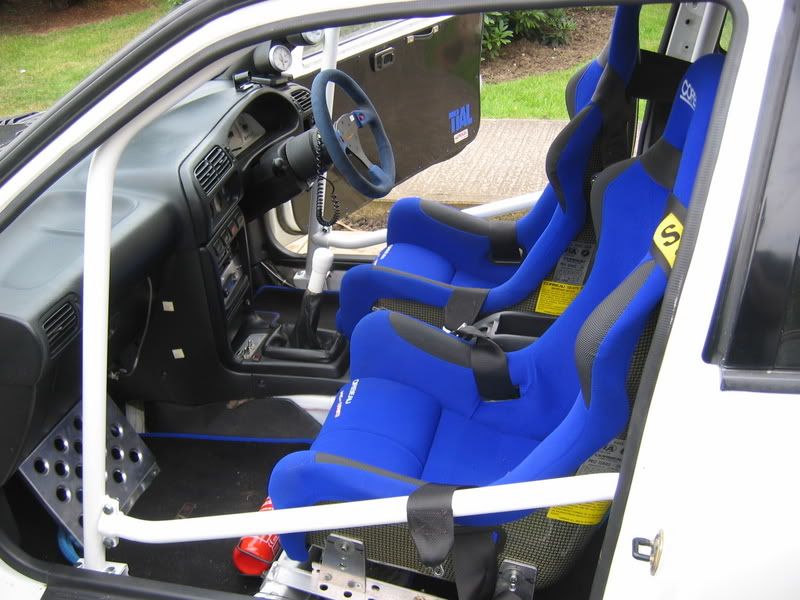

Couldn't find a new pic of my car so i stole one of Si's.. Much the same seats.. I think they look good in Blue..

I agree.... having fitted my buckets on sliders, they are way too high....:doh:
I have to hunker down in the seat or my lid hits the roof....
I have fixed rails now to fit. Should drop them by about 4 inches.

Also where do i get those Bride Rails from? My ones were custom made but those bride ones look like they sit better..
