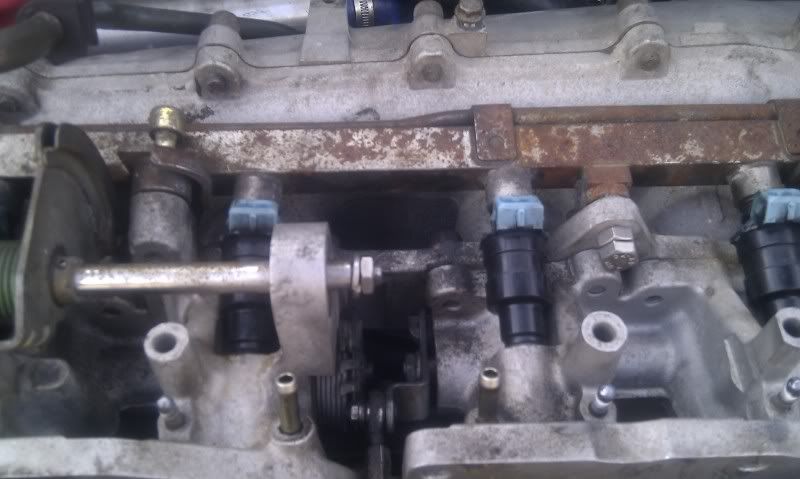

Permanent cure for throttle body rubber caps blowing off.
After having them blow off on a few occasions making the car run like crap I decided I'd make sure it never happened again!
dencon
Mark. I get this problem, more so, if I use anti-lag. How have you done it. I thought the next time my engine is out I would grind off level and weld over. Den.
I cleaned the plating off the end of the tube so it was back to bare metal then put a blob of weld over the end with the tig welder. Possibly a bit over the top but i'll never have to worry about them leaking again!
JIMMYBACK
WOW really over the top but worth it :lol: when can you do mine ;) , Why the Fuck are they there in the first place Grrrrrrrrrr
