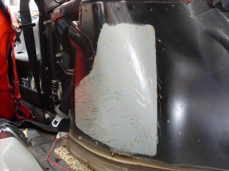

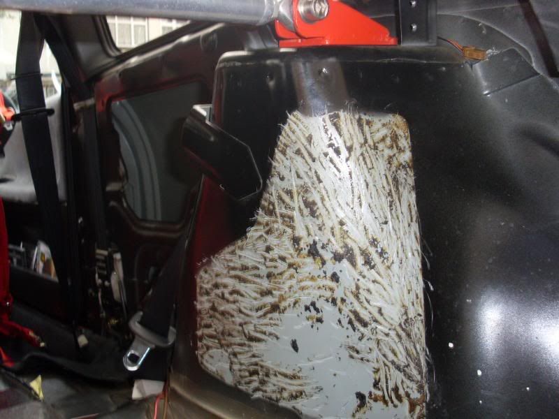

Am not sure what I'm going to do, will need to do a bit of patch work aswell it all looks tidy untill you rip the interior out. I will peel some of the sound proofing off and see how easy it comes up.

That looks like cracking job you have done there looks like you got a very nice finish as well, how long did it take you to get the sound proofing up and prep the car?
